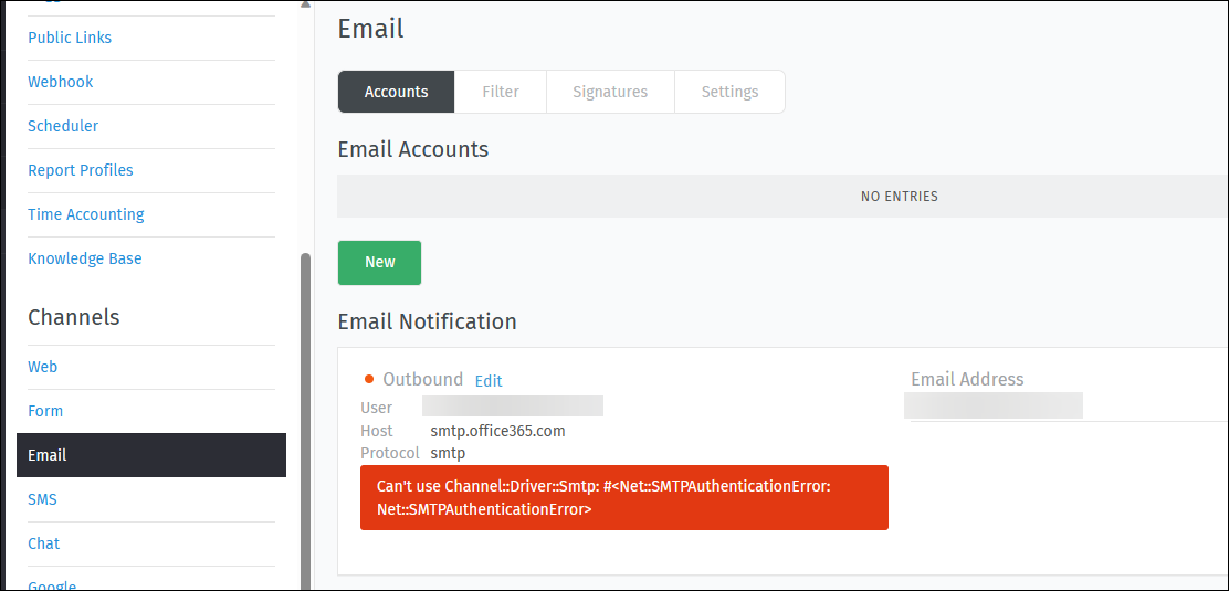

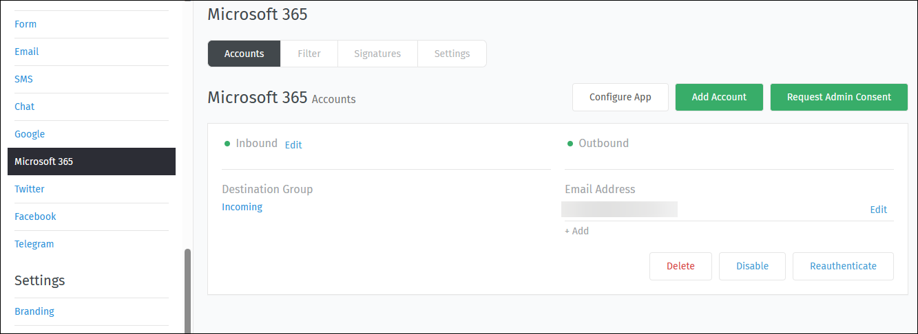

  • Not sure how to reproduce this, we have switched from Email channel to Microsoft 365 channel and did Delete the email channel, but the Email channel still shows an Outbound account.
We had left it as it is because everything else works fine with Microsoft 365, and we have no usability issues. But from October 2023, with Microsoft disabling basic auth for SMTP, we are seeing this "Can’t use Channel::Driver::Smtp: #<Net::SMTPAuthenticationError:Net::SMTPAuthenticationError>
I’m sure Zammad is not using this channel at all because all communications are going through the Microsoft 365 channel successfully, and we see no errors in the M365 account configuration.

You’re mixing up “Email accounts” with the notification account.
The notification channel is technically mandatory and a requirement of Zammad for e.g. agent notifications.
You can configure it to use either SMTP or sendmail.
There’s no possibility to remove it.

You’re indirectly answering your question yourself:
The notification channel, as I mentioned, supports SMTP and sendmail.
It however does not support XOAUTH for Google or Microsoft 365.
The documentation also states this.
So a send connector just for your Zammad instance that doesn’t require authentication (make sure to only allow it for your Zammad host…) could be the solution.
Other solutions might be feasable as well, but depend on your environment and what you can technically do. Most people decide for providers like Microsoft or Google for reasons, be it functionality or “it just working” (most of the times).

Configure a different MTA apart of Microsoft tat supports basic authentication for SMTP.
If you believe this is a missing functionality (as in Zammad should have a Microsoft 365 notification channel), look through the existing feature requests and if you don’t find one, create one here:
Back in the days I did answer that question.
So: Install sendmail with it’s dependencies or use a SMTP server. Otherwise there’s no option.
