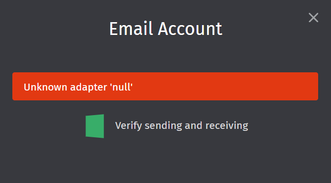

I then go to edit the outbound mail connector to add my SMTP server address and port. When saving I get the following:

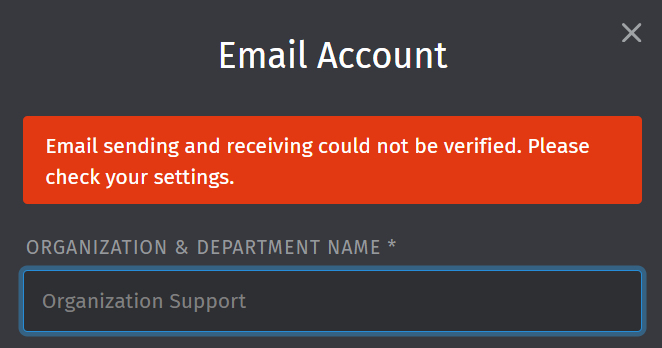

I then cancel the inbound page because I am not using this for inbound:

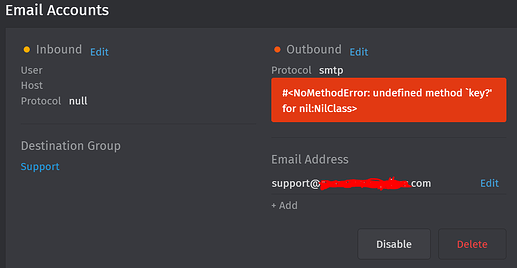

I now have the following error in the email page:
And this in the health page:
Channel: Email::Account out #<NoMethodError: undefined method `key?' for nil:NilClass>
I am also receiving emails from the “email notifications” connector under emails about the above not working. All settings are the same, so I feel this is likely a configuration issue on my outbound-only SMTP connector I created with the rails console.

Unable to send email to 'email@example.com': Can't use Channel::Driver::Smtp: #<NoMethodError: undefined method `key?' for nil:NilClass>
