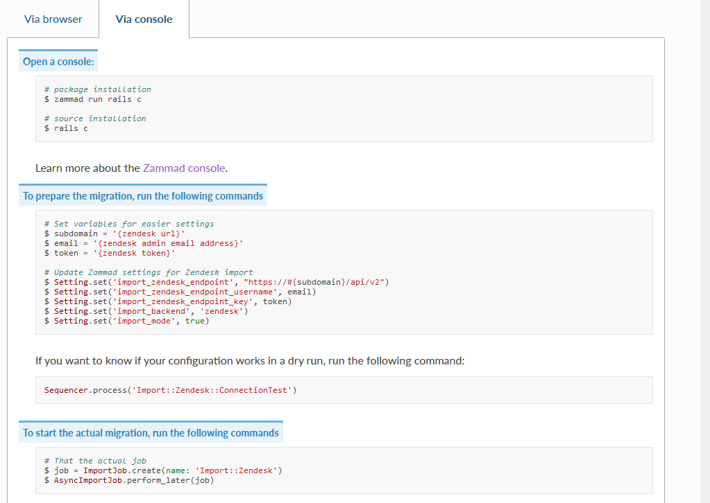

@skip I have been using the Console method, which is why my production.log is so barren.
What do you mean by “set up the nginx server timeouts accordingly,” and what parameters for the workers and concurrent jobs would you recommend?
