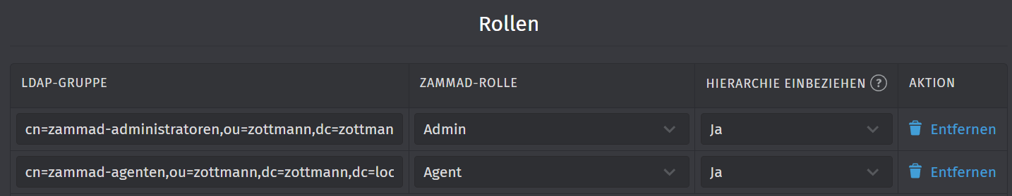

  2. Create a local Zammad user, such as “sysadmin,” with an email address that is not in your Active Directory. However, I recommend creating AD groups like “Zammad Admins” and “Zammad Agents,” then assigning them to the corresponding Zammad roles. You can also create a third group for customers or automatically assign all other users to the customer role.

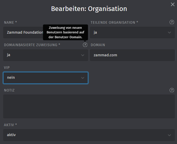

I don’t work with organizations, but I know that you can assign them automatically by the domain name:
