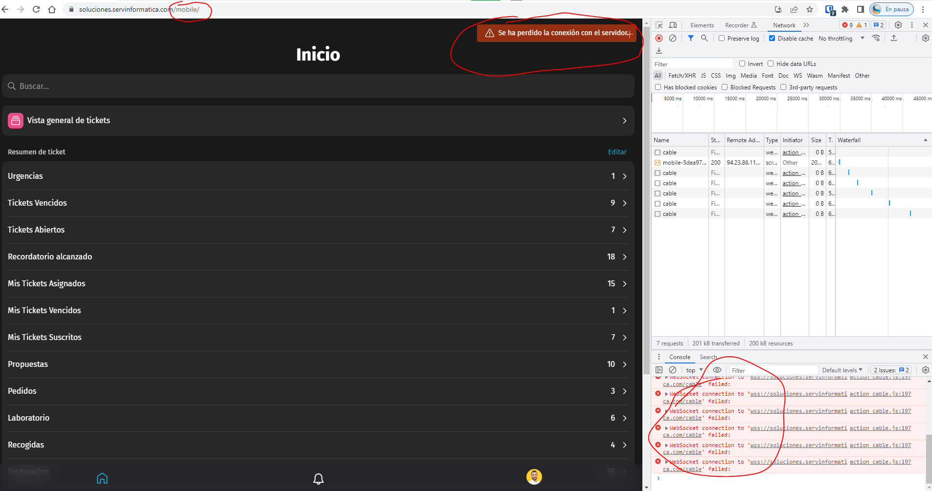

Hi. Same problem here, and I cant to solve it.

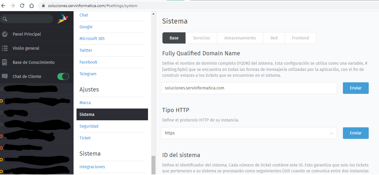

I’ve checked Redis (ping), and vars http_type and fqdn. All correct
Also my apache conf:

I dind’t find where was error for didn’t reach WSS
WebSocket connection to ‘wss://..com/cable’ failed
Can you help me?

I’m also having the problem, that the websocket for localhost:3000/cable is not reachable. I tried different ProxyPass-Parameters without success. http_type is set to https. Setting to http does not matter, the problem exists.
I have installed wscat on my zammad server, to see if the communication works locally. I can access ws://localhost:6042 without any problems. When i run wscat against ws://localhost:3000/cable i got a 404 error. This also happens, if i stop my apache.
On port 6042 there is the websocket-server.rb script listening, on port 3000 there is listening a process called puma.

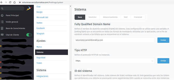

It’s first what i have checked.
Any clue what i can check?
