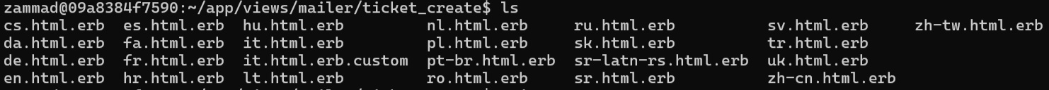

The .custom alternative does not work.
I’ve added the it.html.erb.custom file via docker-compose.override.yml in the nginx and in the railsserver services
The email notification is always the default one.

yeah, same. but a few hours later, I got it :sweat_smile:
I learned a lot about docker again… YAML, anchors and aliases are tricky :sweat_smile:
i looked into every container and it looks like the whole stack uses the files from /opt/zammad/ so adding the volume to zammad-nginx isn’t enough
I edited the docker-compose.override.yml
