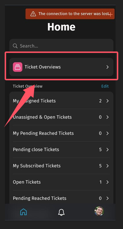

I want to use Zammad as a ticketing system because we have a small number of users, so I haven’t used NGINX. When I use the development mode and start with dev:https using a self-signed certificate, and then open the port for external access on the server, I keep getting the error “The connection to the server is lost” when using the mobile version. I can’t solve it. Do I need to configure NGINX?
I would like to know the purpose of the content inside the red box in the image. It seems to serve the same purpose as the list below.

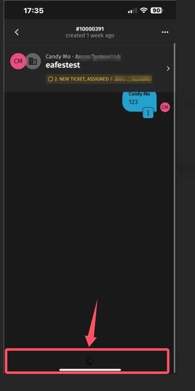

I also noticed that the issue only appears suddenly, which significantly affects the user experience. It seems that the upper part of the page loads without issues, but the reply button at the bottom never works, and the form details page also fails to load. This is quite critical.

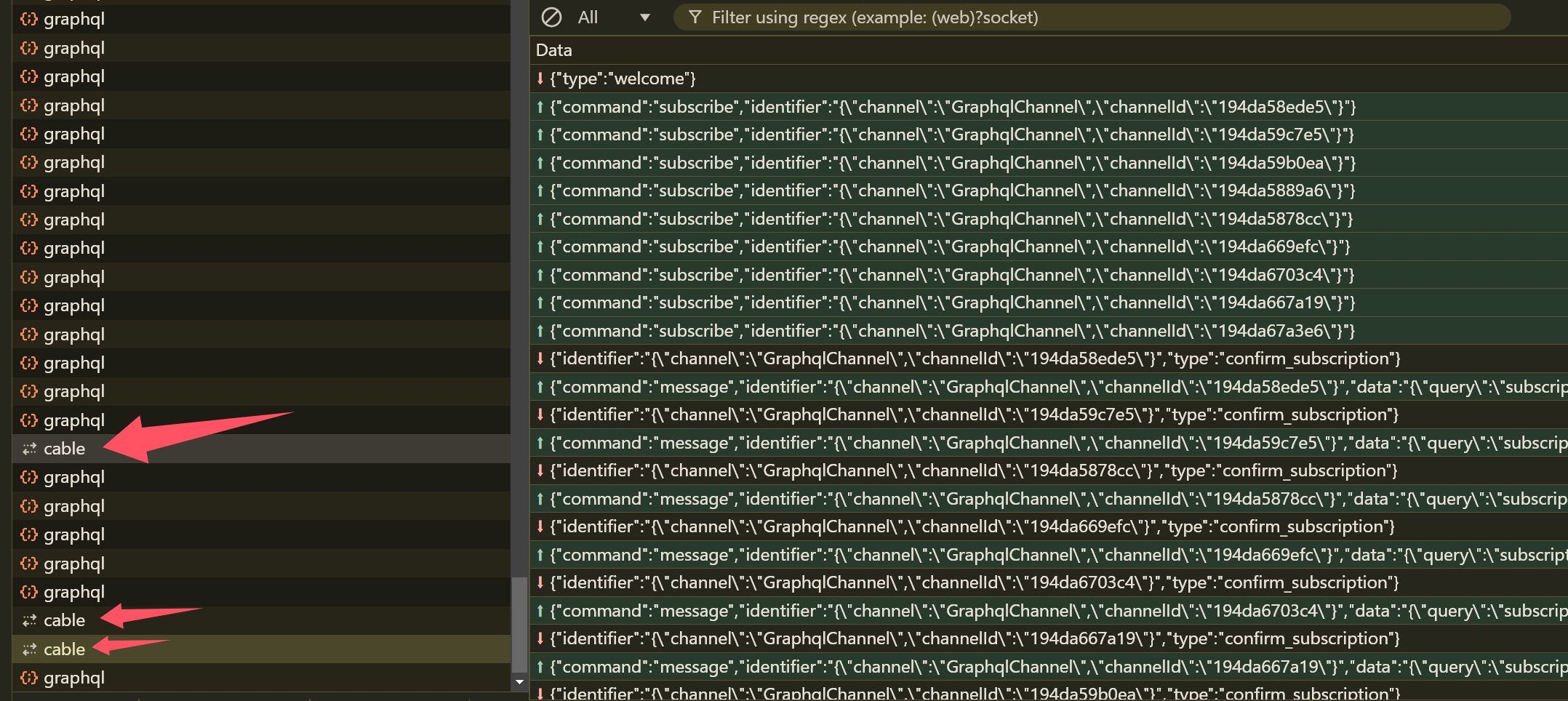

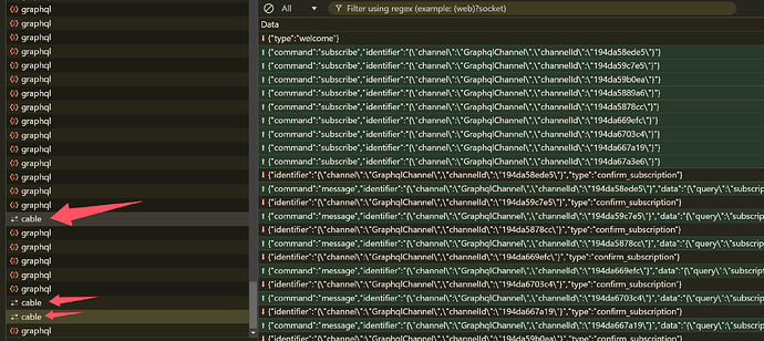

Every time this connection loss issue occurs, it always happens with this, and after reconnecting, it works fine again. I’m not sure why this happens.
I’m considering whether we should open port 6042. Could this help resolve the issue?

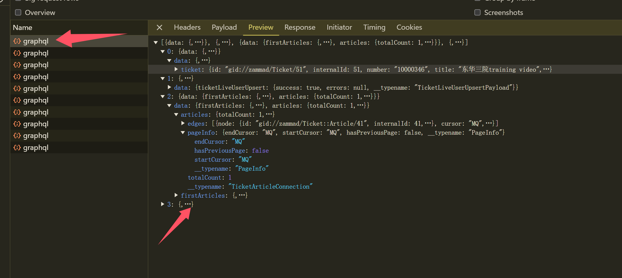

I also noticed that the data for this request seems to come later. I’m wondering if it would be better to handle it asynchronously. A single request might become too large, especially if there are images in the ticket information.

Ah, I’m really sorry to hear that you’re facing this issue. To clarify the problem: I’m using a self-signed certificate to start the service with pnpm run dev:https, and I’m accessing it via https://192.168.10.29:3000. However, when I click on the ticket page, it keeps showing “connection lost” and doesn’t work properly.
When I try accessing https://192.168.10.29:3000 on my mobile phone and repeatedly test by clicking on the page, the same issue occurs. It keeps showing “connection lost.”
Please do not access Zammads Puma directly without proxy in between.
If your cable / websocket connection in general is unstable, you will have to find the reasoning for this.
This is not a classic Zammad issue but might be caused by e.g. firewalls etc.
