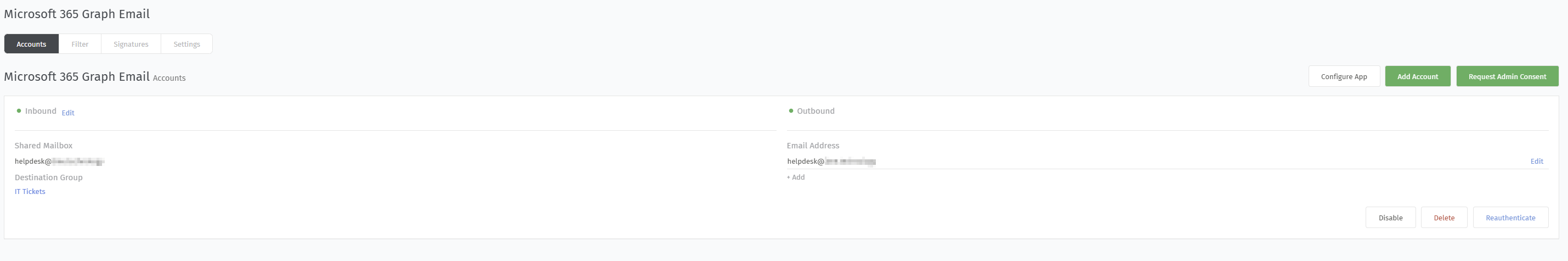

  • Microsoft 365 Graph Email has been configured, this has a signature applied.
  • There is a group “IT Tickets” which All tickets are routed to when they are created using a trigger. This has the sending email address set.
