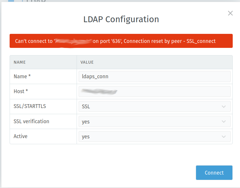

  • Ldap integration error message “Can’t connect to ‘ldap.bla.bla’ on port ‘636’, Connection reset by peer - SSL_connect”
  • Clean install
  • enable LDAP integration
  • fill in the LAP configuration form (image attached)
  • Can’t connect on port 636

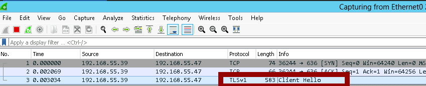

  • I installed wireshark on DC and the connection fails at the first “Client Hello” tls step. Client Hello from Zammad is TLS v1. openssl s_client also tries to connect TLS v1 on zammad server and the rails docker image.

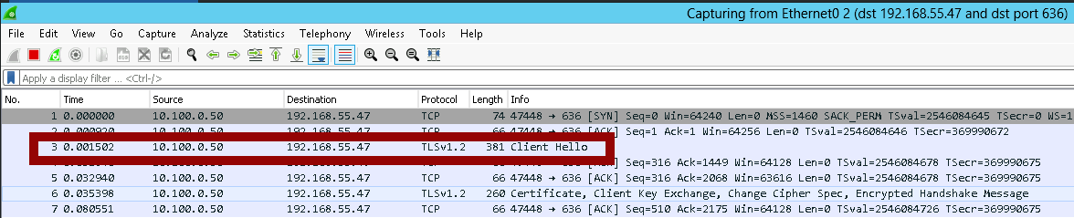

  • Tested another server with openssl s_client -connect to successfully establish (key exchange etc.) a connection TLSv1.2.
