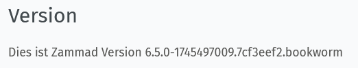

Update to Zammad 7.0
No update to Zammad 7.0
see screenshot
Hi,

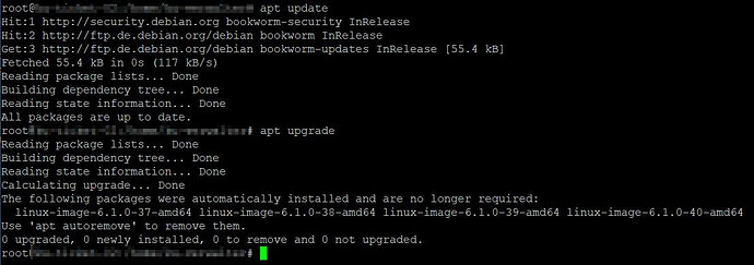

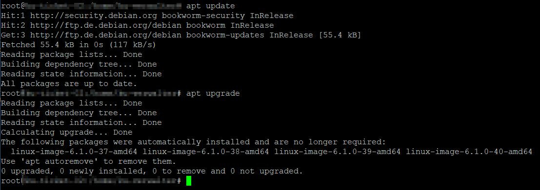

Zammad does not seem to update any more. I followed the same steps as in previous updates, but the process does not seem to work properly:
Maybe someone got a hint for me, what I am doing wrong. It seems we are using a Apache webserver and not nginx.
Thanks a lot for your help!
Hi @Marcel1. Please read the release notes and the update documentation.
What do you mean by “it seems”???
Anyway, I’d check your apt sources in /etc/apt/sources.list.d/zammad.list - maybe yours are still pointing to the previous release?
The Zammad list is not fetched at all. So apt can‘t update. Eigher not existing or disabled.
