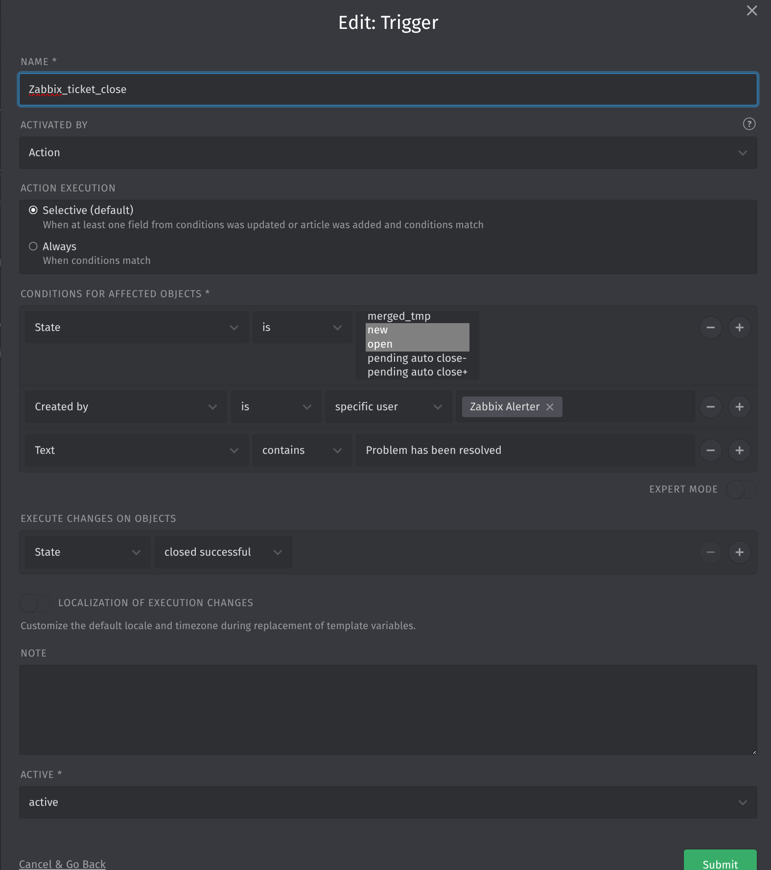

In order to have the tickets auto close when zabbix sends the resolved note you need to have a trigger created on the Zammad side. Something like
-Customer - specific user - (your zabbix user)
-Action is updated
-text contains “Problem resolved in”
Execute Changes
-State closed
This will auto close the ticket.

Perfect, I hadn’t considered creating a trigger in Zammad to automate this.

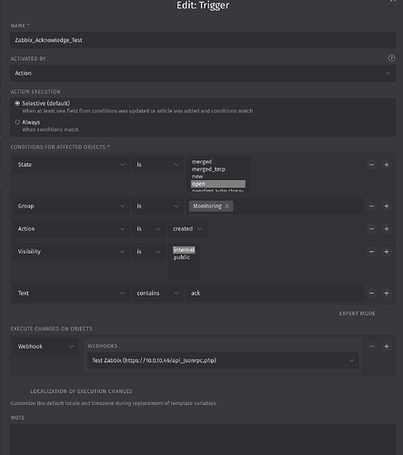

I have a question. If you could help me, would it be possible to create a script so that when a problem is identified in Zabbix and a ticket is created in Zammad, Zammad only sends the ticket number to Zabbix so it can record it? I think this interaction alone would be valid. I wouldn’t want to replicate the other updates made within Zammad within Zabbix, especially since it’s not a ticketing system.
Thank you!

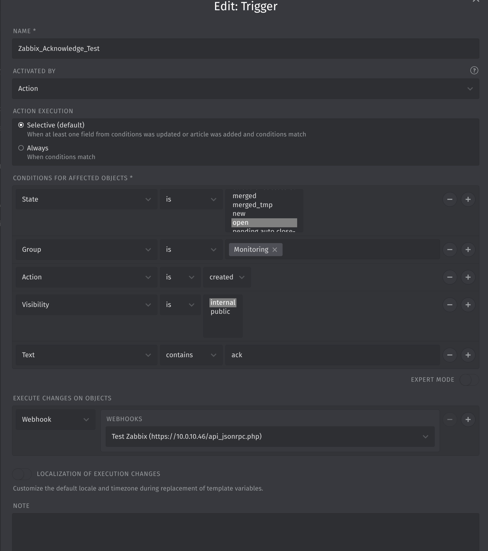

Hello,
in my test instance I tried something similar.
For this test:

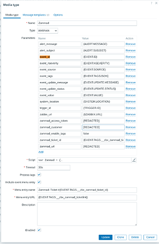

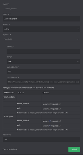

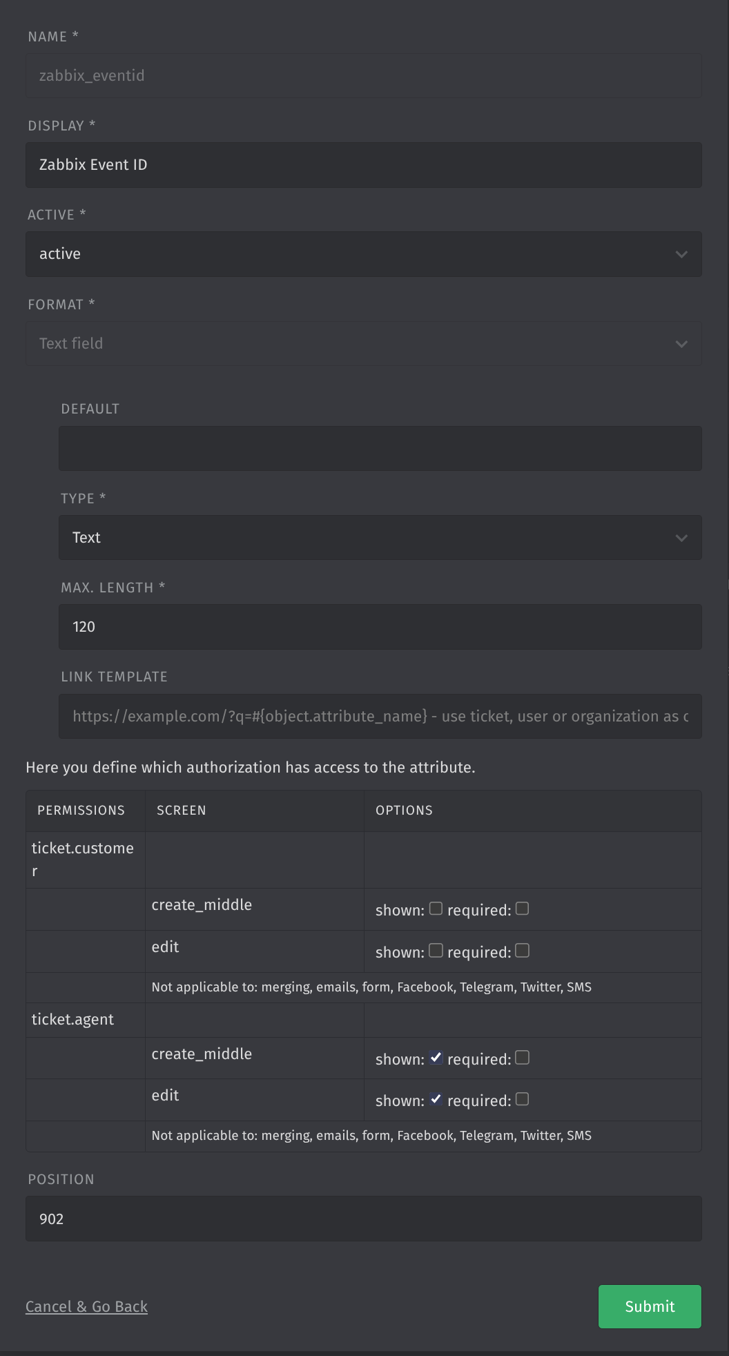

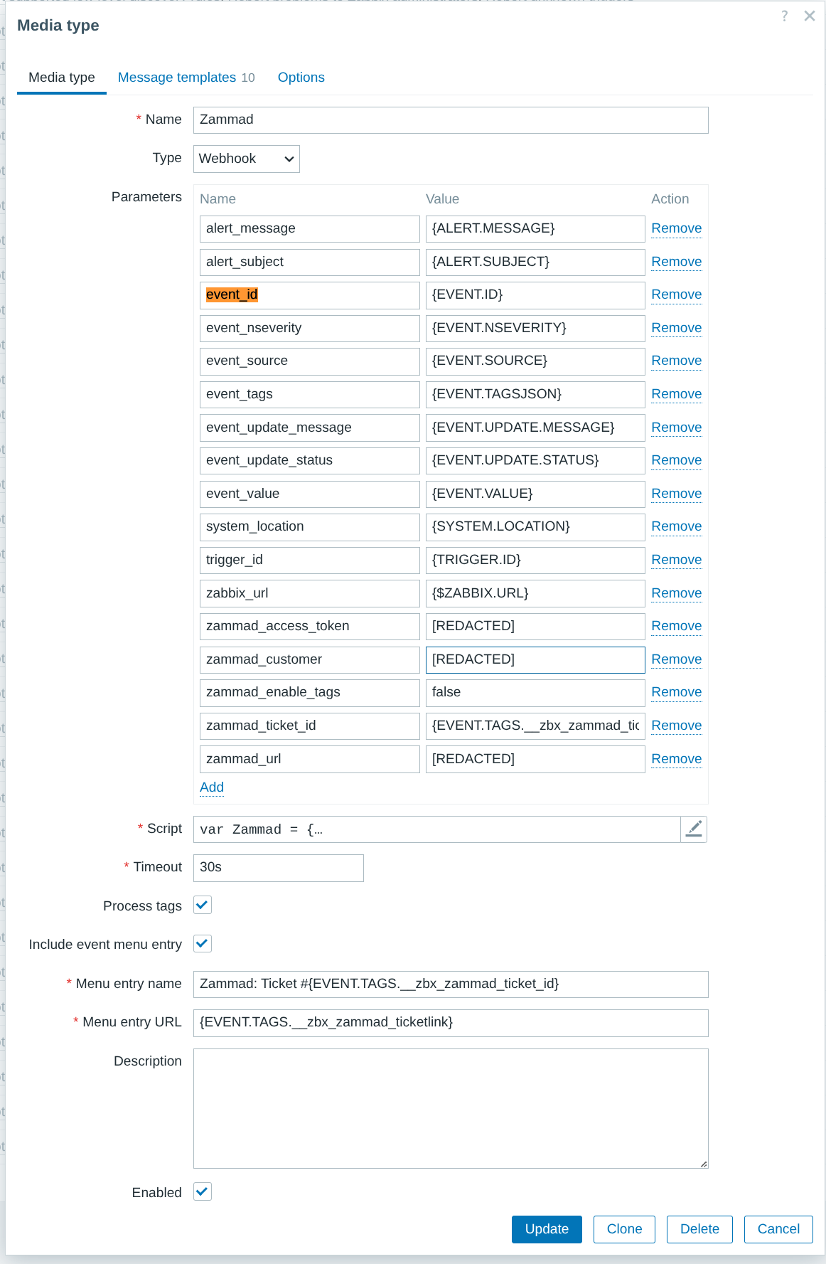

  • I created a ticket object called zabbix_eventid
  • This is The media type setup in Zabbix
  • The Zabbix Event ID is recorded in the ticket itself using this script in the Zabbix media type for Zammad
var Zammad = {

    createTicket: function(subject, message, priority, zabbix_eventid) {
        var data = {
            title: subject,
            group: 'Postmaster',
            article: {
                body: message,
                type: 'note',
                internal: false
            customer: Zammad.params.customer
        if (priority) {
            data.priority_id = priority;
        // Add zabbix_eventid if provided
        if (zabbix_eventid) {
            data.zabbix_eventid = zabbix_eventid;
        var result = Zammad.request('post', 'api/v1/tickets', data);
        if (typeof result.response !== 'object'
            || typeof result.response.id === 'undefined'
            || result.status != 201) {
            throw 'Cannot create Zammad ticket. Check debug log for more information.';
        return result.response.id;
    updateTicket: function(subject, message) {

    Zammad.setParams(params_zammad);
    Zammad.HTTPProxy = params.HTTPProxy;
    // Create ticket for non trigger-based events.
    if (params.event_source !== '0'
        && params.event_value !== '0') {
        Zammad.createTicket(params.alert_subject, params.alert_message, priority, params.event_id);
    // Create ticket for trigger-based events.
    else if (params.event_value === '1' && params_update.status === '0'
             && Number.isInteger(parseInt(Zammad.params.ticket_id)) === false) {
            var ticket_id = Zammad.createTicket(
                params.alert_subject + '\n' + params.alert_message + '\n' +
                    params.zabbix_url + (params.zabbix_url.endsWith('/') ? '' : '/') +
                    'tr_events.php?triggerid=' + params.trigger_id + '&eventid=' + params.event_id + '\n',
                priority,
                params.event_id // this sets `zabbix_eventid`
        result.tags.__zbx_zammad_ticket_id = ticket_id;
        result.tags.__zbx_zammad_ticketlink = params.zammad_url +
            (params.zammad_url.endsWith('/') ? '' : '/') + '#ticket/zoom/' + ticket_id;
        if (Zammad.params.enable_tags.toLowerCase() === 'true') {
            Zammad.setTicketTags(params.event_tags, ticket_id);
    // Update created ticket for trigger-based event.
    else {
        Zammad.updateTicket(params.alert_subject, params.alert_message);
    return JSON.stringify(result);
catch (error) {
    Zabbix.log(3, '[ Zammad Webhook ] ERROR: ' + error);
    throw 'Sending failed: ' + error;

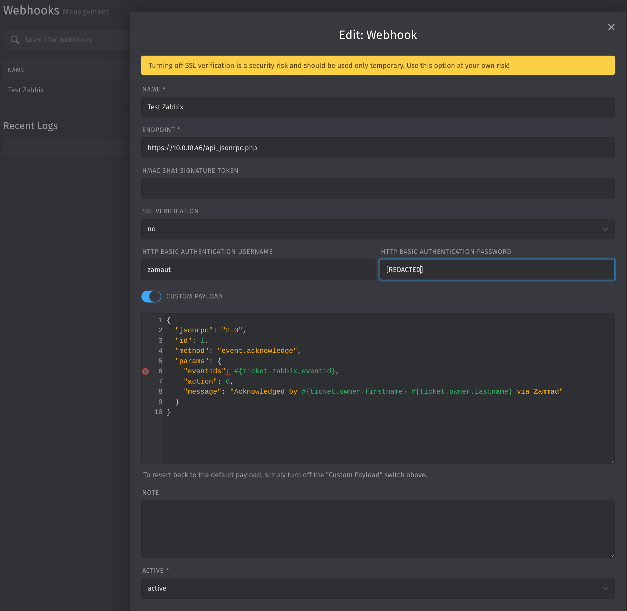

  "jsonrpc": "2.0",
  "id": 1,
  "method": "event.acknowledge",
  "params": {
    "eventids": "#{ticket.zabbix_eventid}",
    "action": 6,
    "message": "Acknowledged by #{ticket.owner.firstname} #{ticket.owner.lastname} via Zammad"
As far as I remember (it’s been a while now), this is how it worked.
Currently, I’m focusing on the Zabbix setup. Over the next few weeks, I’ll attempt to implement it in our production environment. I’m still exploring whether I should add additional custom fields to the ticket system, such as single-selection or multi-selection options, to improve two-way communication between Zabbix and Zammad—at least to some extent.
If anyone has better ideas or suggestions, I’m all ears!
Best,
Skip
