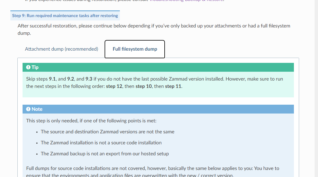

You’re restoring a full filesystem dump of Zammad and this causes the issue. The documentation has clear suggestions to not do that (see: Backup configuration — Zammad System Documentation documentation)
The migration guide even tells you and gives you clear instructions on what to do if you do a full restore:
https://docs.zammad.org/en/latest/appendix/backup-and-restore/migrate-hosts.html
