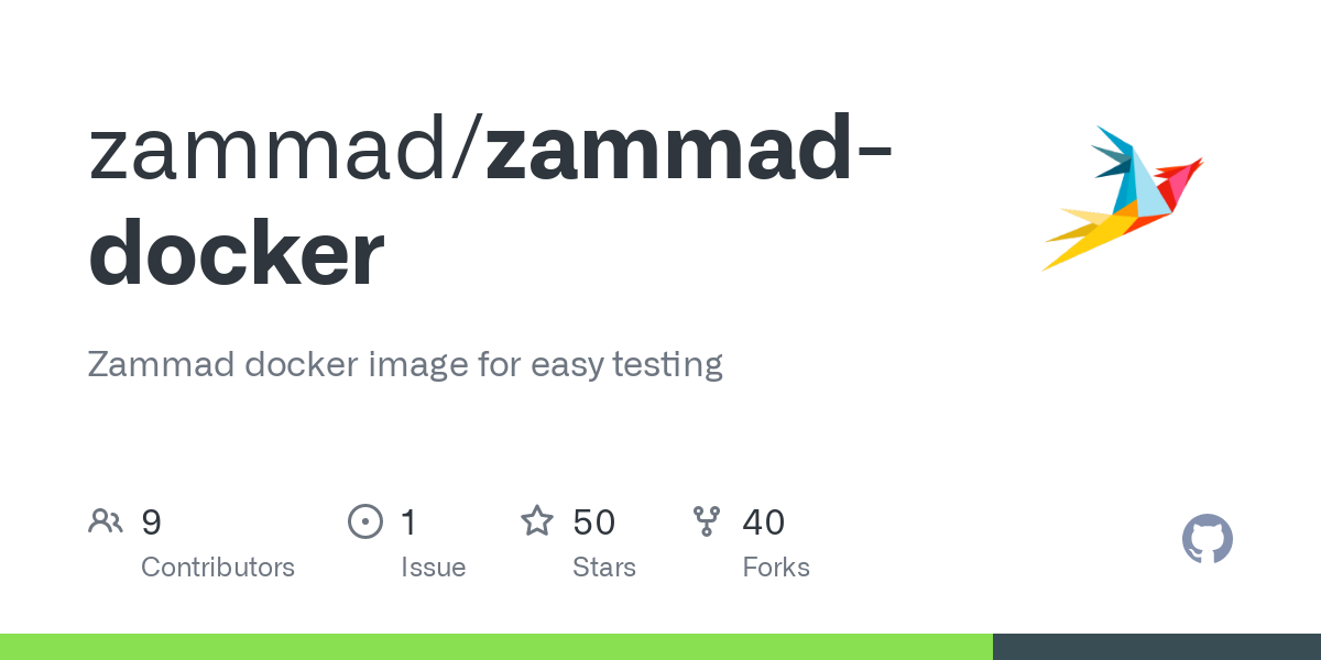

If you consider image space, don’t waste time trying to run zamad in alpine as zammad is currently incompatible to alpine because of https://github.com/docker-library/ruby/issues/113

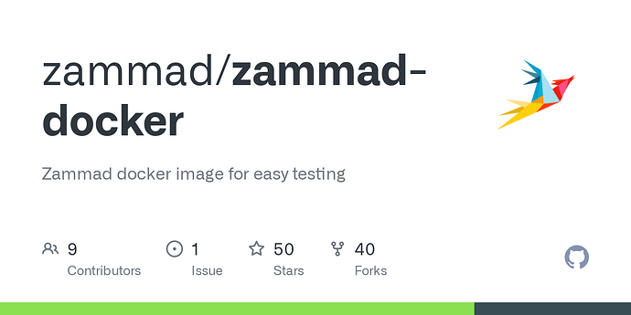

If you want a all in one docker image for development and testing you can use:
Yep completely agree; I like you guys tend to use slim as we need access to all the goodies there and its small enough and saves the fumbling around with apk and package versions which is always painful.
Atm its fine the way it is i think; One thing i had success with was using caddy over nginx tls etc a little easier but only for simple static assets.
thanks for the tip re zammad docker! will take a look!
