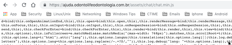

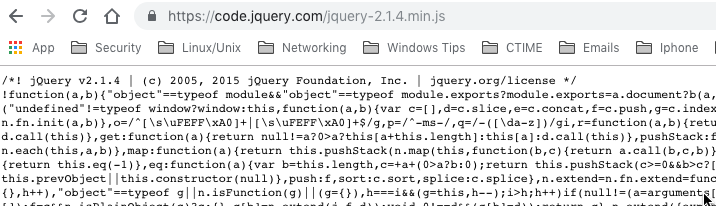

using your test page not show up nothing, i can load all jquery requisites as .js and see all the code on browser inclusive chat.js but when I try to load appears blank

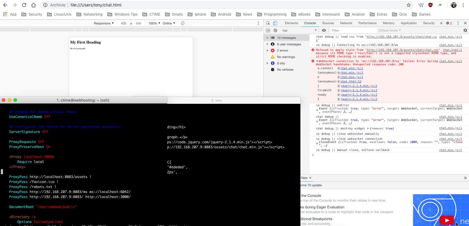

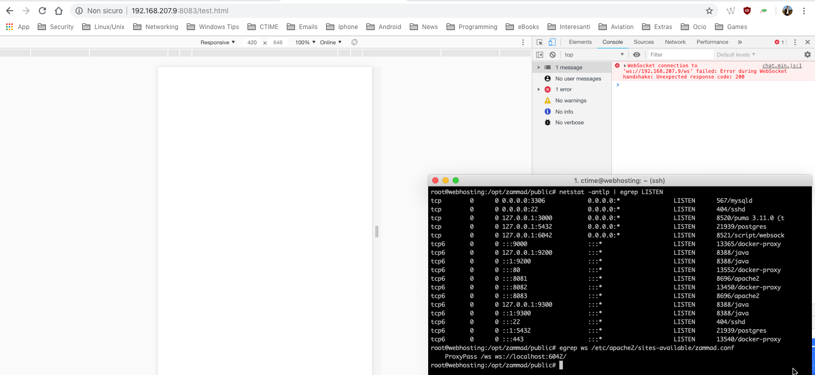

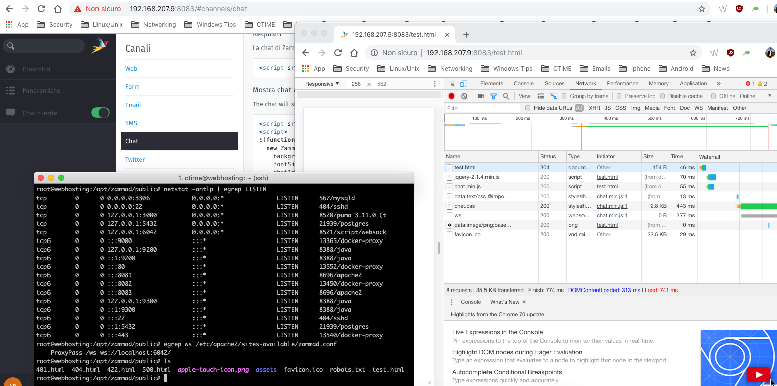

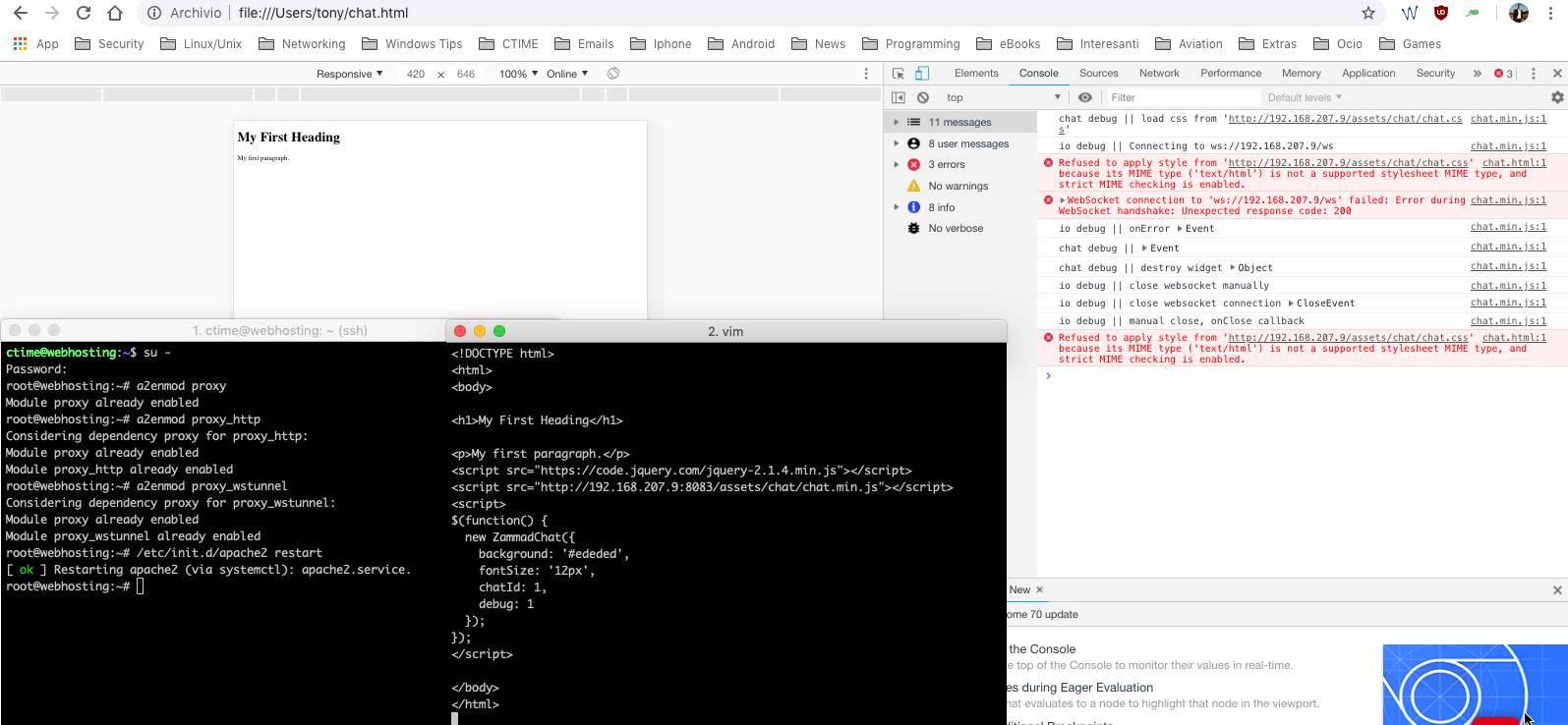

I put the image screenshot… the console log show error with websocket… in the zammad apache configuration explain need to be use a localhost with 6042 port but this one is up too…and still no show the chat window.
I want to add. the apache config is a virtualserver by default into port 80 a mediawiki for our wiki intern… and the zammad site is running on 8083 custom port, so any request to can enable chat windows must to be pass under 8083 not 80 directly… so I think need to be change the zammad.conf but what I can change ??
