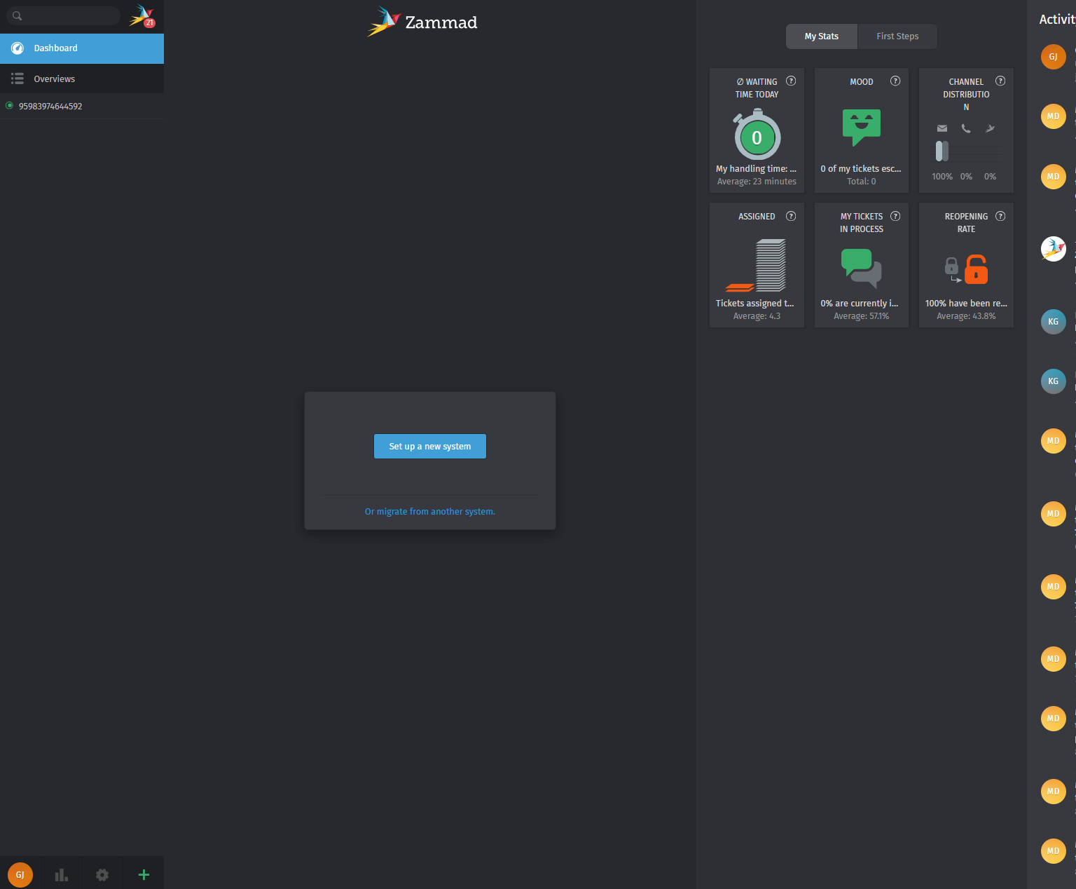

For any reason, our Zammad system is pointing back to “Setup a new system” screen.
This happens multiple times a week, sometimes daily.
Checking the value Setting.get("system_init_done") it returns false
When this is happening, everybody can click this “Setup a new system” button.
It happens complete unexpected, even then when nobody is touching the system. It smells for a bug but unfortunately I have no idea how to look deeper or what to look for in logs to find any root cause.

I have found my problem.
Was returning true.
My problem was in the link i was opening https://domain.com/#getting_started, the #getting_started was forwarding me to login screen and opening the Setup New System.
I was looking for weeks on this easy problem.
Just wanted to share my findings on this issue, i know they might not be related.
I cannot manually force my Zammad installations to the getting started page, with system_init_done being true.
I get redirected to the login screen, after logging in i get this.
But when using a link without #getting_started, then i don’t get anything
