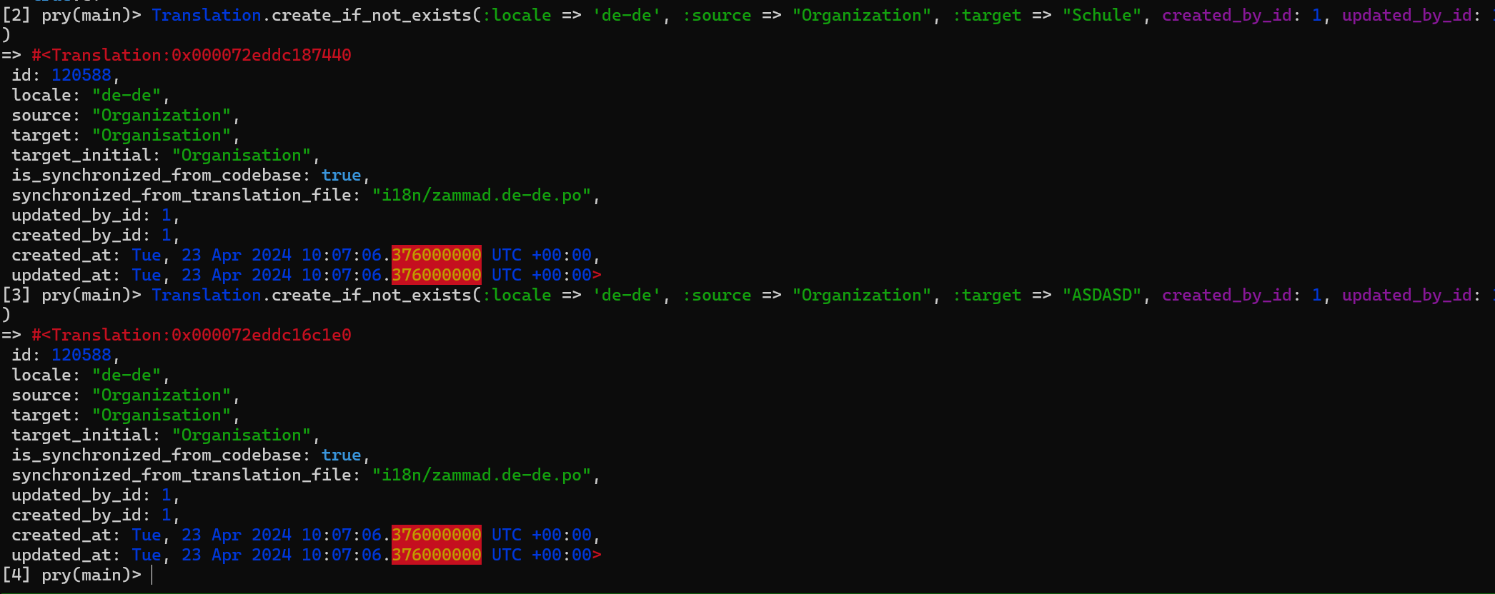

  • It works for Customer or custom states

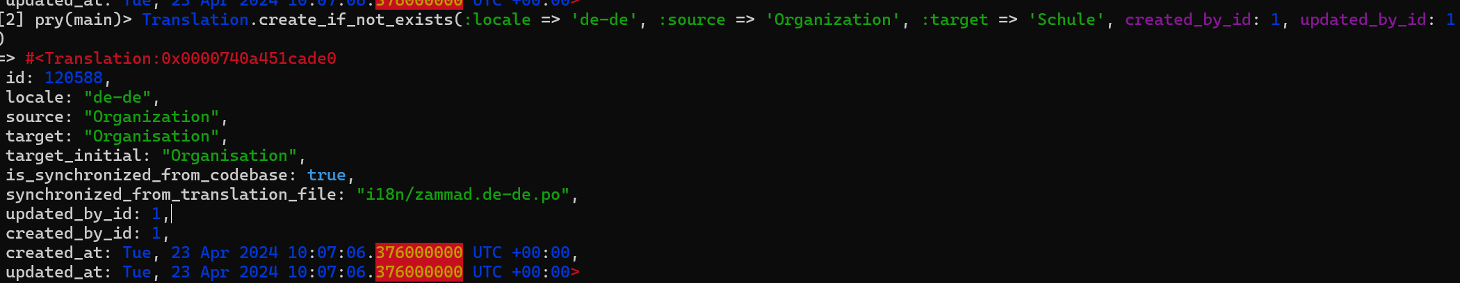

    • Translation.create_if_not_exists(:locale => 'de-de', :source => 'Customer ', :target => 'DSB', created_by_id: 1, updated_by_id: 1)
  • Open the Rails console zammad run rails c
  • Try to translate withTranslation.create_if_not_exists(:locale => 'de-de', :source => "Organization", :target => "Schule", created_by_id: 1, updated_by_id: 1)

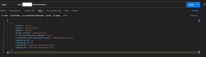

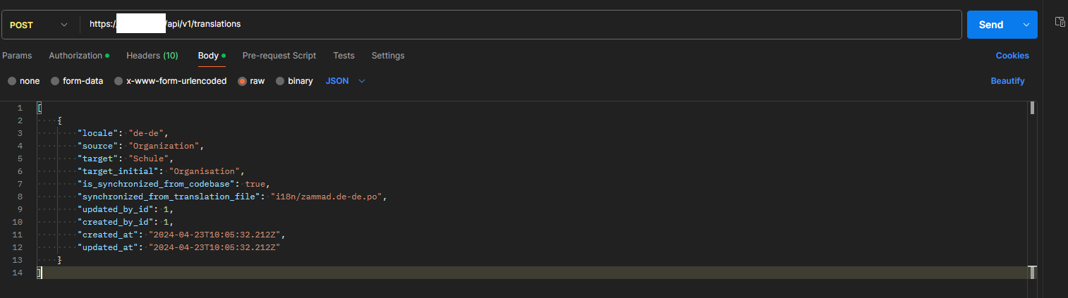

I also tried to push it through the API but without luck :pensive:
        "locale": "de-de",
        "source": "Organization",
        "target": "Schule",
        "target_initial": "Organisation",
        "is_synchronized_from_codebase": true,
        "synchronized_from_translation_file": "i18n/zammad.de-de.po",
        "updated_by_id": 1,
        "created_by_id": 1,
        "created_at": "2024-04-23T10:05:32.212Z",
        "updated_at": "2024-04-23T10:05:32.212Z"

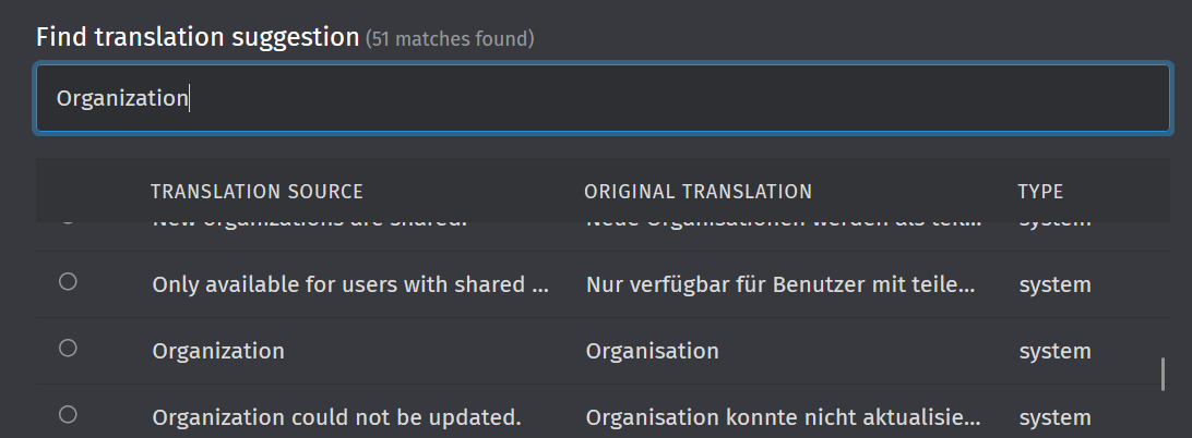

Probably because “Organization” is an already translated attribute? Have you tried switching your profile language to the target language? “Organization” gets translated, as well as the maintenance page text.
I agree, it is already translated to Organisation in german.
But I want to change that to Schule
It works with Customer which is Kunde but I can translate it to DSB using the rails console.
That is weird, as this translation should already exist as well. You might need to look into replacing the existing translations instead of trying to create new ones with the create_if_not_exists function, because it should already exist and fail to create a new one, but that is just my interpretation based on very basic Rails commandline skills.
Very weird :grin:
Also because Customer also already exists, but it is possible to change it’s translation with create_if_not_exist

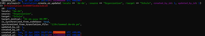

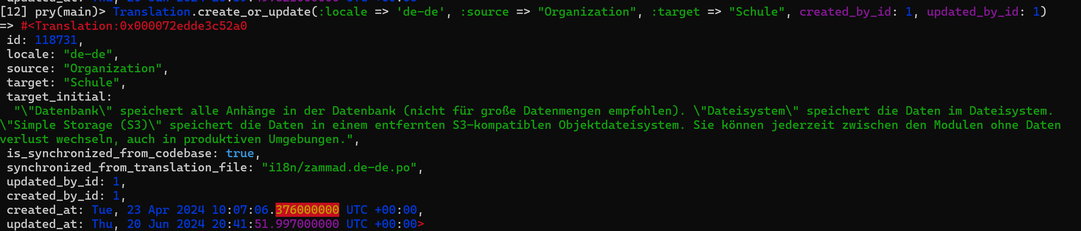

Now I tried with create_or_update but instead of updating the translation with id 120588
and it is generating random translations
