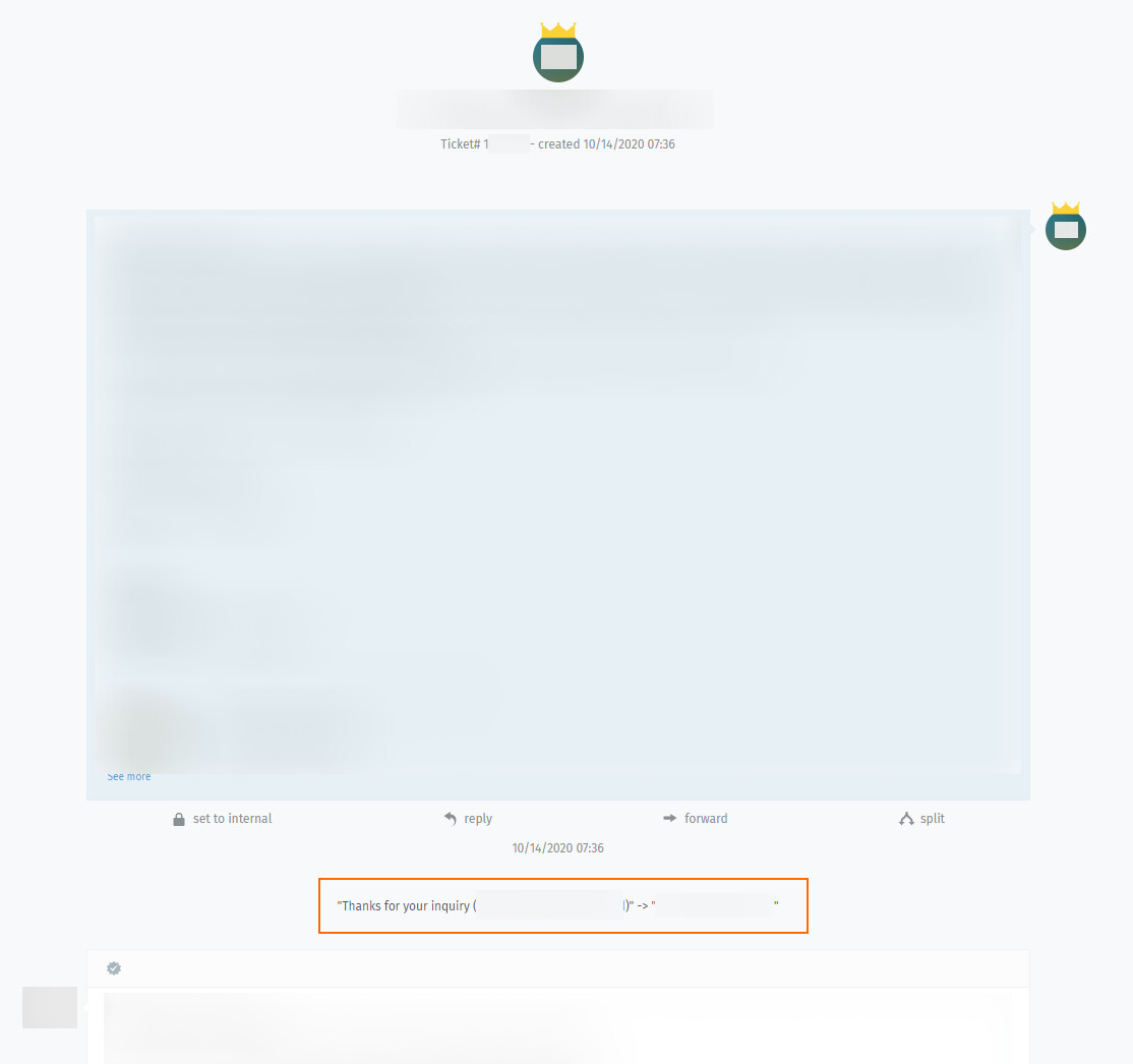

If a trigger based email is sent, you’ll also see that in the ticket in question. That’s an additional indicator if everything configured attempts to work.
