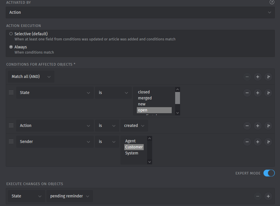

Wouldn’t something like this work? State ‘open’ is whatever state your tickets are before a customer answers. State ‘pending reminder’ should be your custom ‘Customer Updated’-state. The action field is referring to Article - not the ticket.
Thanks @DD4PK,
Ah, if the action refers to an article then yes that would make sense. Will give this a go and report back.
For the record: My attempts with Schedules did not work.
That appears to be working.
I left the match state out as upon thinking about it, I realistically want to know if a customer responds to a ticket regardless of it’s state.
I guess this would not trigger if the customer logged on and changed something but that’s a bit of an edge case I think.
The fact that this works also seems to fly against the docs I referenced about but I wonder if that means that simply changing a value will not cause triggers to fire but the act of updating (whether by button press or other) does fire the triggers… Not sure how that should be worded to be clearer but I think it needs work.
