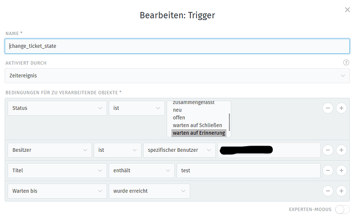

Hello community,
trying to trigger an event (when waiting time has been reached). Seems that I don’t get the logic behind or the trigger simply doesn’t do what it’s supposed to.
Zammad Version is 6.5.0-1750055263.dd6ae287.focal (ubu 20.04).

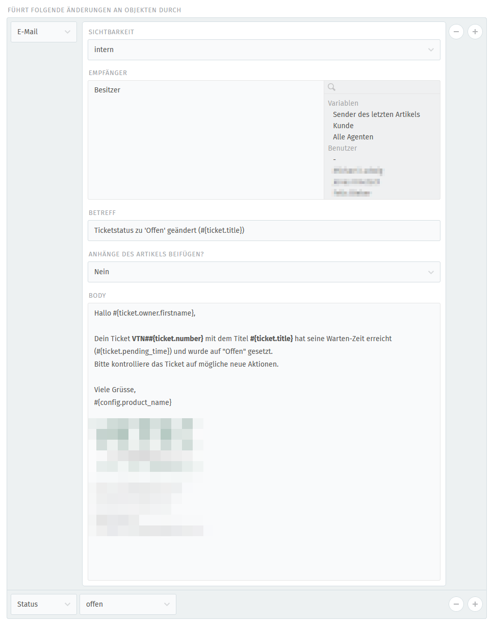

Screenshot of trigger with some additional checks to not touch the active, non-testing tickets.
The problem is that the trigger does nothing.
Any ideas on what I’m doing wrong?

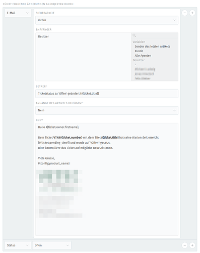

What changes did you set to be done?
These are the changes: Send mail and set status to open.

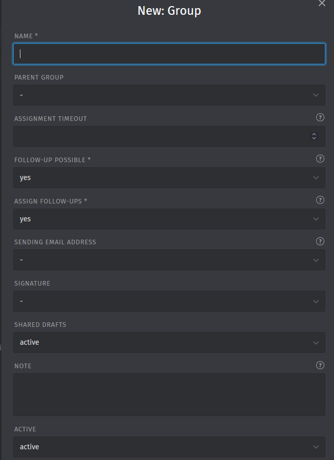

It works for me. Did you set a sending mail address for the group in question?
okay, very good, thanks for your time testing this. Can you explain what you mean by saying setting a sending mail address for the group?
What group? And do I have to set a sending mail address? Where can I do that?
The overall mail configuration is okay, as Zammad receives and sends out mails regulary.
Each group needs a sending mail address assigned, if you intend to send mails to the users in it.

It depends on which group this owner is assigned to. Look up the group and see if there’s a sending mail address set. Or just remove the sending mail part from your trigger config and see if the state gets changed.
The user is part of all (5) groups present in zammad. All groups are active. In every group the user has full rights.
All groups have the same outgoing mail address set. There is only one outgoing mail address in our zammad system.
I think i made a mistake there. Users aren’t assigned to groups. The ticket is assigned to a group. But if you made sure that a sending email address is set for it, then the only other possibility in my opinion is that your conditions don’t match the ticket.

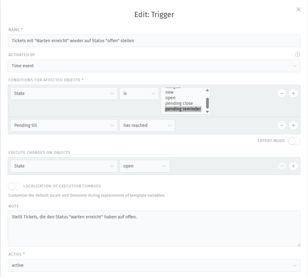

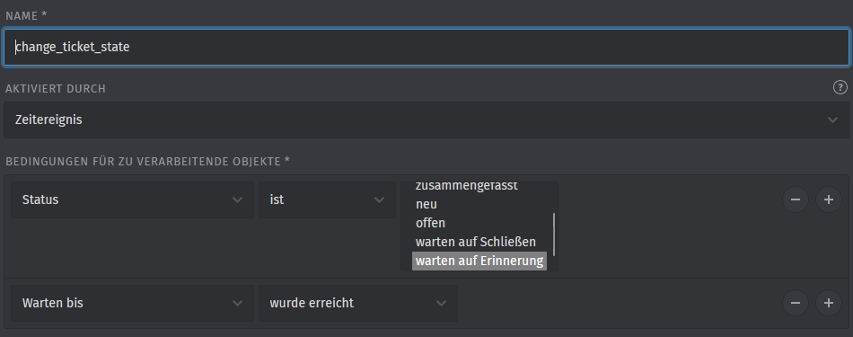

I don’t know if you still have issues but my trigger for this is simply this and it works every time
Thanks a bunch for all your feedback.

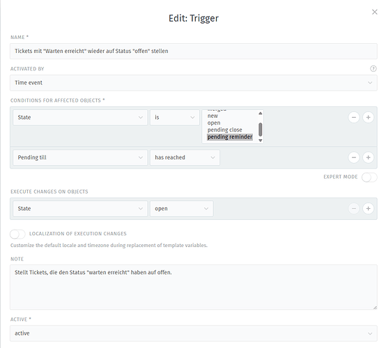

I changed my trigger to reflect your settings, so now I have to conditions as shown in your screenshot (state = pending reminder, pending till = open) and three actions (write note, create mail, state = open).
This works, as long as the ticket has only been touched once by the trigger.
If you work on the ticket and set it back to pending reminder, when the time is over the trigger won’t get executed again.

A little late for an update, but well, here we go.
The trigger conditions are now what @Claud11 has proposed and it works very well.
It writes a note into the ticket and sends out a mail to the ticket owner.
