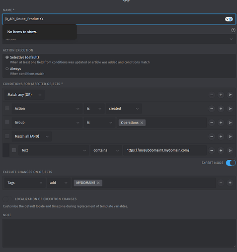

OK… so maybe I could use tags or something similar, got it (I will try).

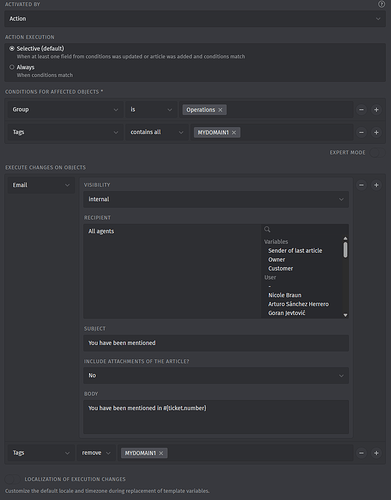

All I know is that every time I had to create a trigger and i had to place a bunch of conditions i had trouble with that trigger, that is why i started using priority with Global, Deprtment logic ever since then i have no problems at all.

Yes, I got something working on the test system that seems to work (instead of using a tag I used a new tree_select field, but taking that aside followed your suggestion). I can tell you by a 100% if it works, once I have it on the production sytem and some real load on it (not just test tickets :))

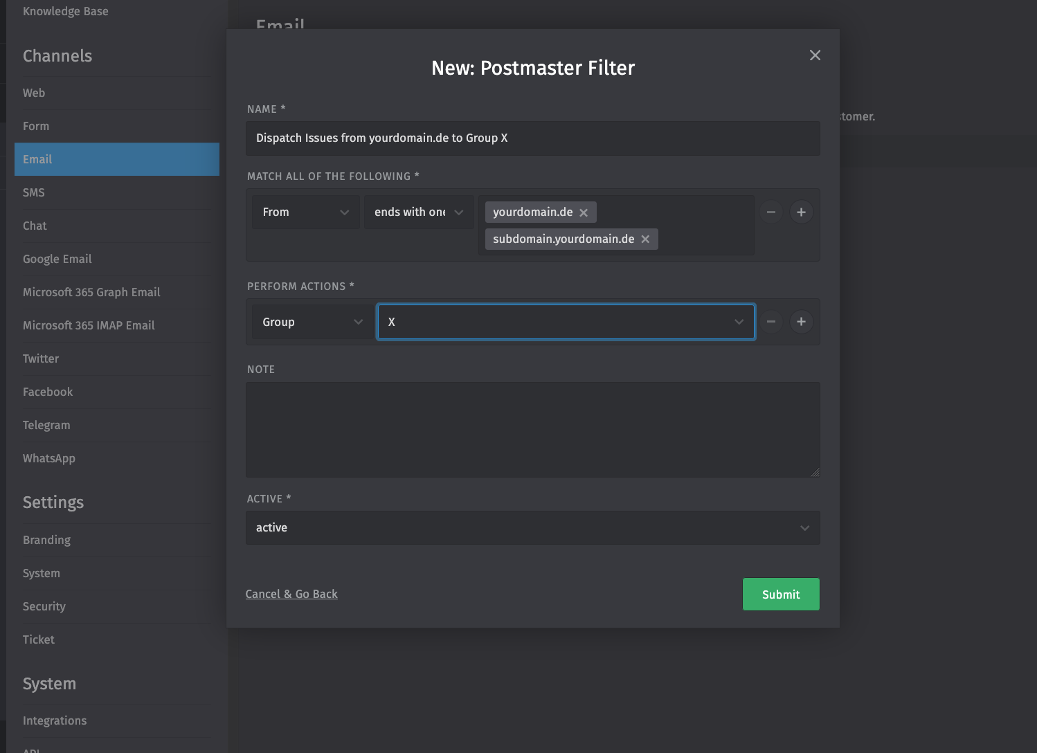

that you basically you want to route your ticket on a reliable criteria (domain) to a certain group.
First off with the newest release 7.0 (there’s no official release date yet), there will be KI Agents at your disposal. These will allow you to use prompts and as a KI Agent type a Group Dispatcher act exactly as your current trigger do.
Then let’s take a step back to your current situation in 6.5.0. I prefer simple solutions, and you could use E-Mail filters (Manage > Channels > Email > Filter) instead. They will reduce the load on your system and remove the hassle of figuring out the async execution order. It will achieve the same result.
