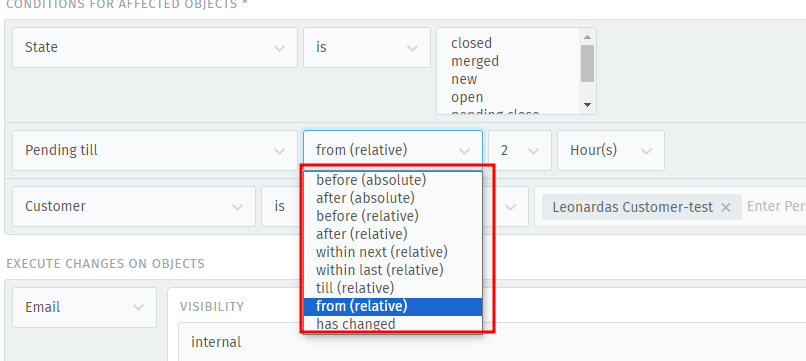

Trying to setup a triger, but something goes wrong every time :smiley:
Use case. Today is 2023-10-04.
Ticket set to Pending reminder, date set 2023-10-10 8:00
If customer reply to the ticket till that date, it goes to New, all good.
I wanna achieve, that if date reaches, system send email to Owner, and put ticket to status Open. So the Agent could review ticket again and make needed actions.
Also i wanna make other triger, that after 48 hours after ticket was put to Pending reminder, it send notification to customer.
Can someone help me how to setup a trigers? :slight_smile:
I am strugling to understand what those values means and when to use them.

Can you explain what means “wait until relative”?
It will wait to what? value i endered in pending reminder? or what?

So if i setup wait until (relative) value, so the date and time entered in ticket on setting “Pending reminder” is useless or used in different purpose?
Also is there somewhere examples and explanations what does means those values and how to use it?
Just quick question - you said before that this is automation i need. :slight_smile:
What are in Zammad automation? Sheduler?
