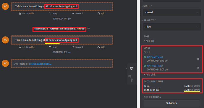

I have a script that interfaces with a phone call database that uses the Zammad API to create tickets with time accounting articles. Many calls can be logged for a single ticket, so we need to merge these tickets manually to have an accurate accounting.
Currently, the time accountings remain on the ticket they were created on even though the article the time accountings are associated with have been merged with a different ticket.
  1. Which are one or two concrete situations where this problem hurts the most?
When I merge two tickets and I see all articles are migrated to a single ticket, the time accountings remain with the empty ticket. This requires me to manually merge time accountings if I want to use this feature.
  1. Why is it not solvable with the Zammad standard?
Ticket merging needs to be properly implemented across all standard features. Ticket Time Accounting is part of Zammad standard, so it should also behave consistently with the other ticket attributes.
  1. What is your expectation/what do you want to achieve?
I want to assign the amount of time spent on phone calls (from multiple calls) to a single ticket, but I want to create separate tickets initially as this is a limitation of my automation (I can’t know in advance what ticket I should log the call to). Merging tickets seems like a convenient way to merge time from multiple phone calls into a single ticket without needing to manually enter the time for each call.
This feels a bit like a foreign key violation, though not quite.
The ticket_time_accounting table entry references both the ticket_article_id and the ticket_id. It’s just weird that the time_accounting object and the ticket_article object would reference two different tickets.
I can’t find a way to migrate existing time accountings using the API. My two options to work around this are to either detect inconsistencies and then delete and create through the API, or do direct database modifications to change the ticket ID of the time accounting objects to match the article’s ticket ID.
