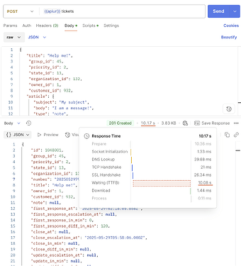

  • Creating a ticket (via API or GUI) takes a long time — usually between 9 to 10 seconds, and sometimes even up to 20 seconds.
  • Call the /api/v1/tickets endpoint to create a new ticket.
  • Observe the response time and logs.

  • As shown, the request takes 9427ms to complete.
  • It executes 547 queries — is that expected?
