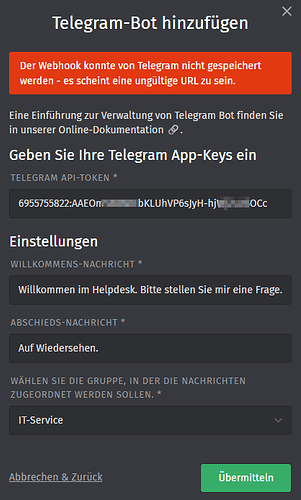

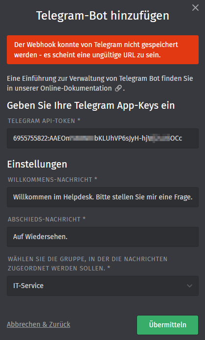

Telegram Channel Error: invalid URL
  • Used Zammad version: 6.3.1
  • Operating system: Debian 12
  • Browser + version: Chrome (newest version)
  • Adding a Telegram channel should work
  • It doesn’t work. The error message is: The webhook could not be saved by Telegram, seems to be an invalid URL.
  • Set up an telegram channel.
From production.log (I changed the API key in some parts):
I, [2024-07-31T18:54:59.230501#26717-150260]  INFO -- : Started POST "/api/v1/channels_telegram" for 192.168.101.0 at 2024-07-31 18:54:59 +0200
I, [2024-07-31T18:54:59.254174#26717-150260]  INFO -- : Processing by ChannelsTelegramController#add as JSON
I, [2024-07-31T18:54:59.254237#26717-150260]  INFO -- :   Parameters: {"api_token"=>"6955755822:AAEOmKKA88DdKLUhVP6sJyH-hjXsYsZSOCc", "welcome"=>"Willkommen im Helpdesk. Bitte stellen Sie mir eine Frage.", "goodbye"=>"Auf Wiedersehen.", "group_id"=>"1"}
E, [2024-07-31T18:54:59.589601#26717-150260] ERROR -- : The webhook could not be saved by Telegram, seems to be an invalid URL. (Exceptions::UnprocessableEntity)
app/controllers/channels_telegram_controller.rb:24:in `rescue in add'
app/controllers/channels_telegram_controller.rb:21:in `add'
