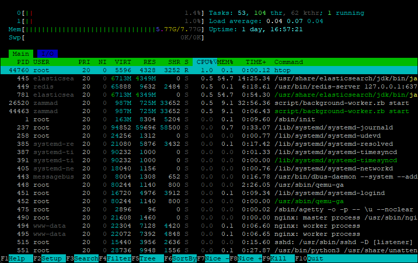

htop

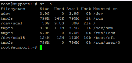

df -h

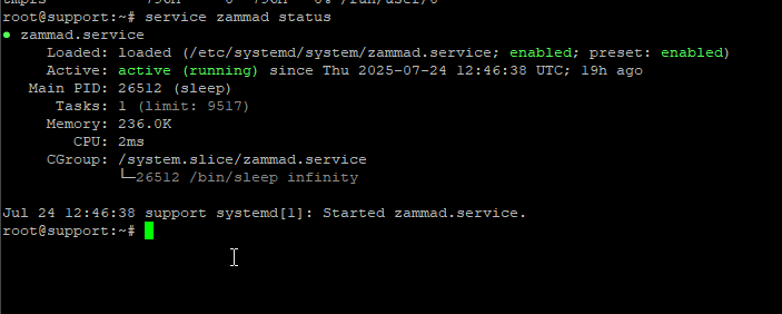

service zammad status

Thanks for at least showing some system information. A couple of additional questions:
  • Any indication of issues in the Zammad production.log?
  • What does the Admin System => Monitoring page say regarding the Current status?
  • What does your database logging say?
  • Any other interesting messages in the generic system logs?
  • When exactly did you notice this behaviour and what did you do before that? Did you update or change anything recently?
I’d throw my “database max connection setting too low” guess into the ring.
Or too low web concurrency.
I’d say something has changed or was changed. Those things usually don’t appear suddendly after “months of being fine”
