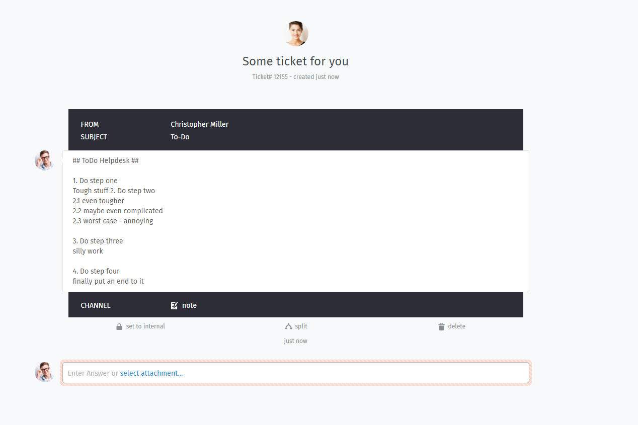

So I went to search what the heck Zammad hates about parsing in that part…
Zammad parser absolutely hates you trying to use several lines… you might want to put everything in one :smiley:
So:
	"group": "Sales",
	"title": "Some ticket for you",
	"owner": "",
	"customer_id": 12,
	"note": "Notiz",
	"tags": null,
	"article": {
		"subject": "To-Do",
		"body": "## ToDo Helpdesk ##\n\n 1. Do step one\n Tough stuff 2. Do step two\n 2.1 even tougher\n 2.2 maybe even complicated\n 2.3 worst case - annoying\n\n 3. Do step three\n silly work\n\n 4. Do step four\n finally put an end to it\n",
		"type": "note",
		"internal": false
Result looks like this:
When taking a look into the API-Documentation, you could also use HTML if needed, but keep it in one line. :slight_smile:
Uhm that’s strange because the line break is working perfectly fine for me.

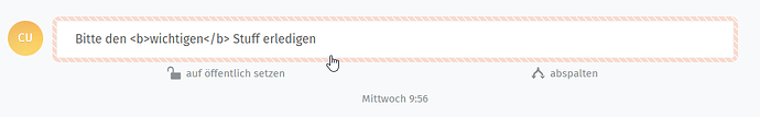

Not working for me :frowning:. I also had a look at Introduction — Zammad System Documentation documentation before but didn’t find anything about HTML formatted requests. Is this the wrong documentation i’m looking at?
Nevertheless, I tried with the following:
 "title":"Ticketname",
 "group":"Helpdesk",
 "owner":"",
 "article":{
  "subject":"To-Do",
  "body":"Bitte den <b>wichtigen</b> Stuff erledigen",
  "type":"note",
  "internal":true},
 "customer":"cronjob",
 "note":"Notiz",
 "tags":"",
 "location":""
And i got this:
Try to add "content_type":"text/html" to the article JSON, that’s what the UI does. It’s easy to see when you use the browser devtools while creating a ticket. The request from my test in the browser:

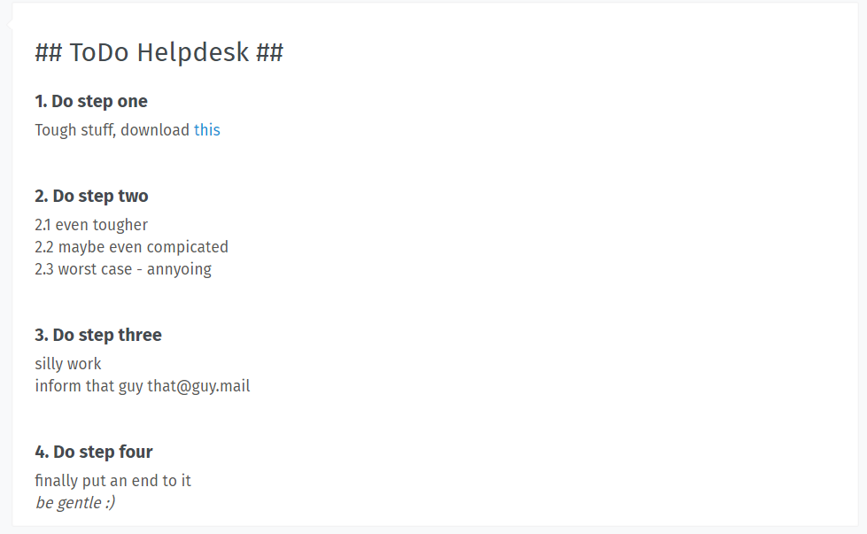

In case anyone wants to do the same, here’s our “final version”.
The script that launches the ticket (systemd service) had to be tweaked a little and now looks like that:
[Unit]
Description=periodische Tickets erstellen %I
[Service]
ExecStart=/usr/bin/curl -k -H "Authorization: Token token=THATSMYTOKEN" -H "Content-Type: application/json"  --data '@/home/zammad/periTickets/%i'  https://MYZAMMADSERER/api/v1/tickets
User=zammad
Changed: the quotes after the --data param have been changed to apostrophes so the html code gets interpreted correctly.
The file referrenced by %i now looks like this:
  "title":"Some ticket for you",
  "group":"Helpdesk",
  "owner":"",
  "article":{
   "subject":"To-Do",
   "body":"<div><h1>## ToDo Helpdesk ##</h1></div>
 <div><h3><b>1. Do step one</b></h3></div>
 <div>Tough stuff, download <a href=\"https://myfancydownload.url\">this</a></div>
 <div><br></div>
 <div><h3><b>2. Do step two</b></h3></div>
 <div>2.1 even tougher</div>
 <div>2.2 maybe even compicated</div>
 <div>2.3 worst case - annyoing</div>
 <div><br></div>
 <div><h3><b>3. Do step three</b></h3></div>
 <div>silly work</div>
 <div>inform that guy <a href=\"mailto:that@guy.mail\">with this mail</a></div>
 <div><br></div>
 <div><h3><b>4. Do step four</b></h3></div>
 <div>finally put an end to it</div>
 <div><i>be gentle :)</i></div>",
 "content_type":"text/html",
 "type":"note",
 "internal":false},
 "customer":"that one guy",
 "note":"Notiz",
 "tags":""
This results in a ticket looking like this:
The only thing not working (yet) is the mailto link.
