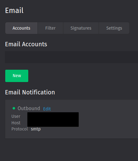

Thanks for your reply. The channel is not created (at least there is nothing in the UI). I would assume that nothing further would be done if the verify does not complete successfully, and this is not happening because Zammad is not even attempting to send out the verify email.
Is there anything else I can do or check? eg. logs?
Is there any way of adding the channel without verification?
Thanks
