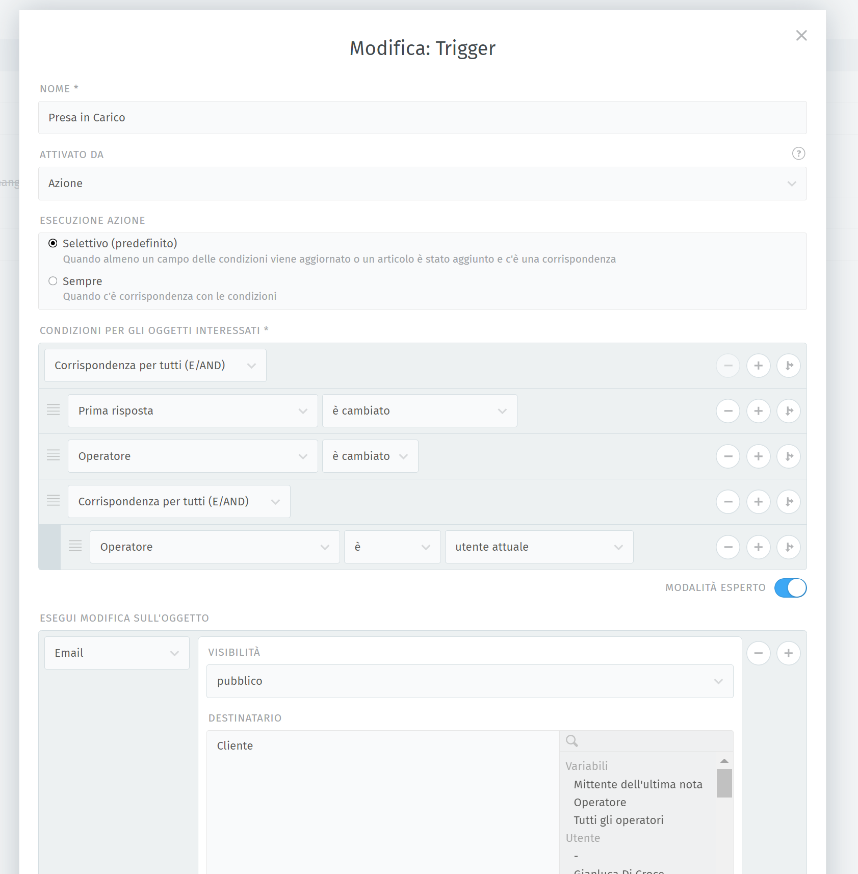

My trigger to send an email is configured as the following
The issue is that first response can be set only from a manual web operation
Thanks a lot for your support

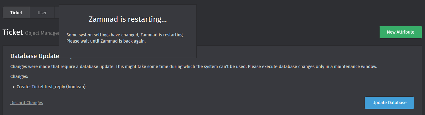

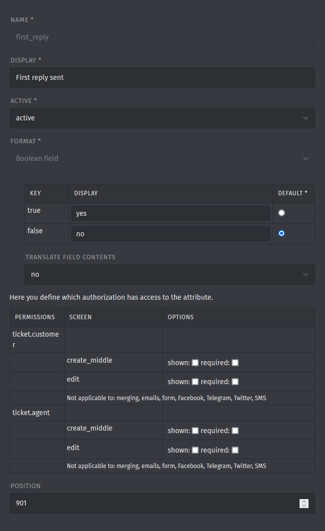

Create a Ticket Attribute under Objects and call it what you want, in my example first_reply as boolean, and hidden from everybody else (in this case you will be able to see the status only in the rails console) set false to default
Remember to update the database and restart zammad

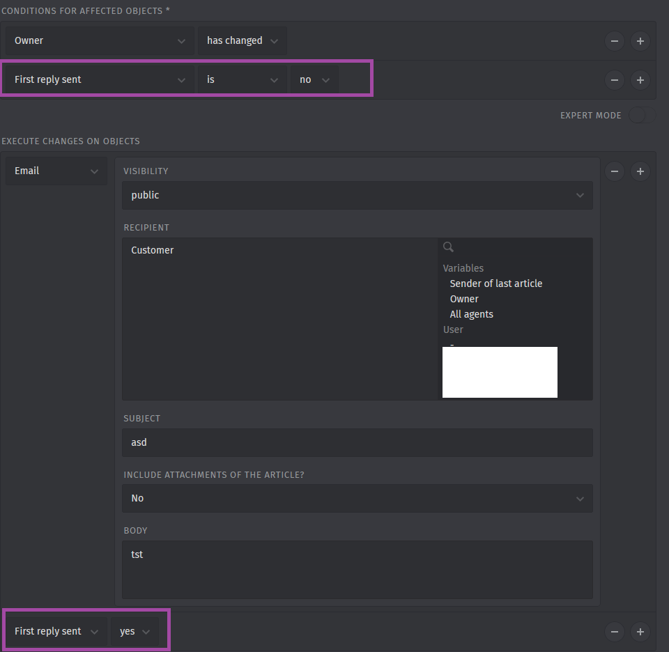

And finally set a trigger like this:
The magic lies in changing first_reply from no to yes once the trigger is activated.
This way
a) when you use the macro, the owner is changed
b) the trigger sees the owner change, sends an email to the customer and sets the attribute to yes
c) further owner changes will not trigger anymore
d) you can control if the email has been already sent
e) make macros and triggers play together nicely
