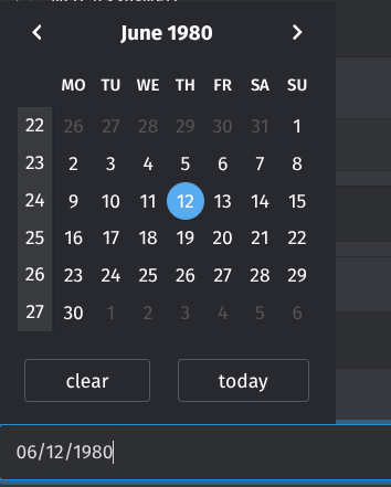

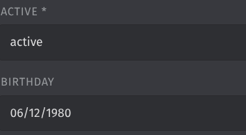

Next, I added several birthday dates for customer users:

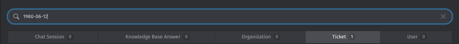

According to the search documentation here, it’s possible to search by the YYYY-MM-DD format for dates.

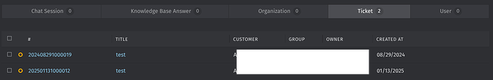

When searching for customer.birthday:1980-06-12, I was able to find the tickets associated with that birthday.

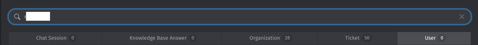

There must be something I am overlooking, the funny thing is, I cannot find the user using the surname either :thinking:. There is probably something wrong with my staging instance since on the production one I can search per surname.

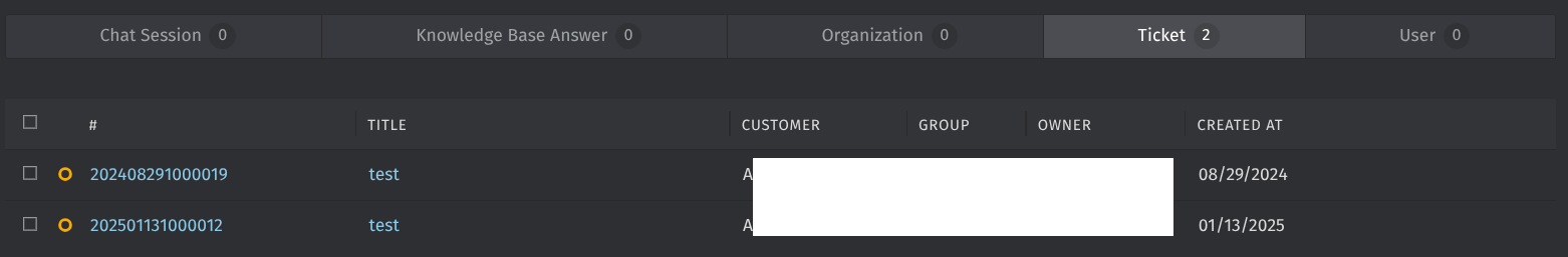

While the Console yields the expected search results, the search with “customer.birthday: YYYY-MM-DD” doesn’t put out users or tickets belonging to the users.
