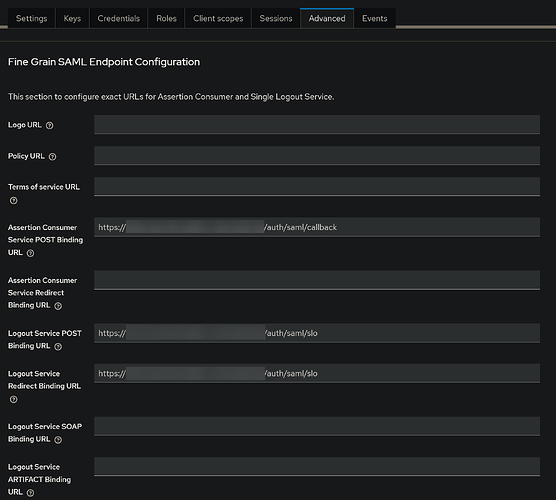

Is the logout URL on the Keycloak side configured correctly?
By clicking Sign-Out you mean inside Zammad?

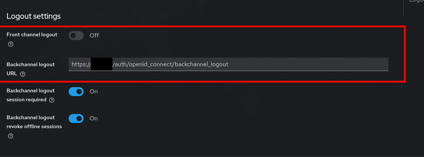

This article describes the same problem but with OAuth2 but this dosent solve the Problem: Open Id Button shows error message after Zammad session ended instead of a login Window. · Issue #5657 · zammad/zammad · GitHub
Hey, in the link you provided it was suggested to do that:
After some testing, I can add for **Keycloak**, that setting a Backchannel logout URL resolves the issue. Heads-up: You need to turn off the "Front channel logout" in your client's general settings in Keycloak for the setting to appear
When I disable “Front channel logout” - (turn “off”, click on save and reload my browser) I’m not able to configure as described, because I don’t have the three logout-settings / options in the post.
while it should (?) look like in the post from github:
Using keycloak 26.3.2 - so should be pretty up-to-date. Maybe this is because SAML is usead instead of OICD?
Also, just turning it off didn’t help.
I set up SAML with keycloak bc there are official guides for it hoping it would work as expected - (talking about SAML with Keycloak — Zammad Admin Documentation documentation ) - so I did it exactly as described there.
EDIT - Maybe solved
It seems like when I configure Logout Service POST Binding URL in the Advanced client tab to https://zammad.domain.de/auth/saml/slo and turn off Front channel logout it looks like it’s working.
like:
So not sure If I missed that in the documentation or if it needs to be added…
