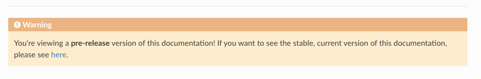

I’m trying to do the same as initially posted, i. e. copied my database and files archives into a newly created restore directory of the backup volume as described in Backup & Restore (Docker) — Zammad System Documentation documentation After starting again the entire stack, I expected the database and files storage to be updated with the new archives and afterwards the restore folder to be renamed. But nothing happens at all. How can I troubleshoot this or precisely get the restore folder processed as expected?
Thanks
Andreas
That is because you’re looking at a pre release documentation page.
This functionality comes with Zammad 7.0 and is not available in Zammad 6.5, the current stable, as of now.
So you will have to wait for the release if you really wanna use that functionality.
The page also warns you about this fact
Ah ok. Thought it would be already available at least as some kind of beta functionality in 6.5 Basically I want to switch from package based to containerized installation to reduce host OS dependencies and simplify maintenance. Is release 7 expected to come during the year or even during the next months?
Thanks
Andreas
It’s on the way, generally no ETAs are communicated though.
