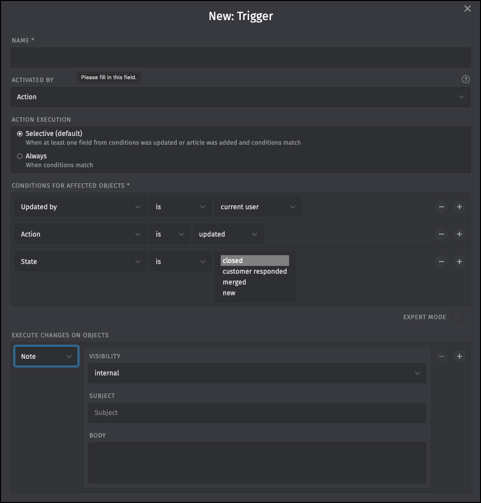

So I had a look at triggers and I can see how it would be possible to identify tickets which are being changed to state “closed” by the current user, but I cannot see any option to then require a note to be submitted as part of closing a ticket - only option for object “note” is that of adding a predefined note:

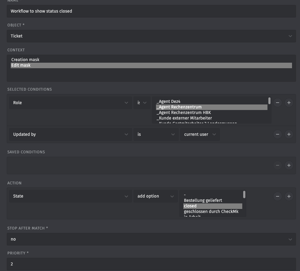

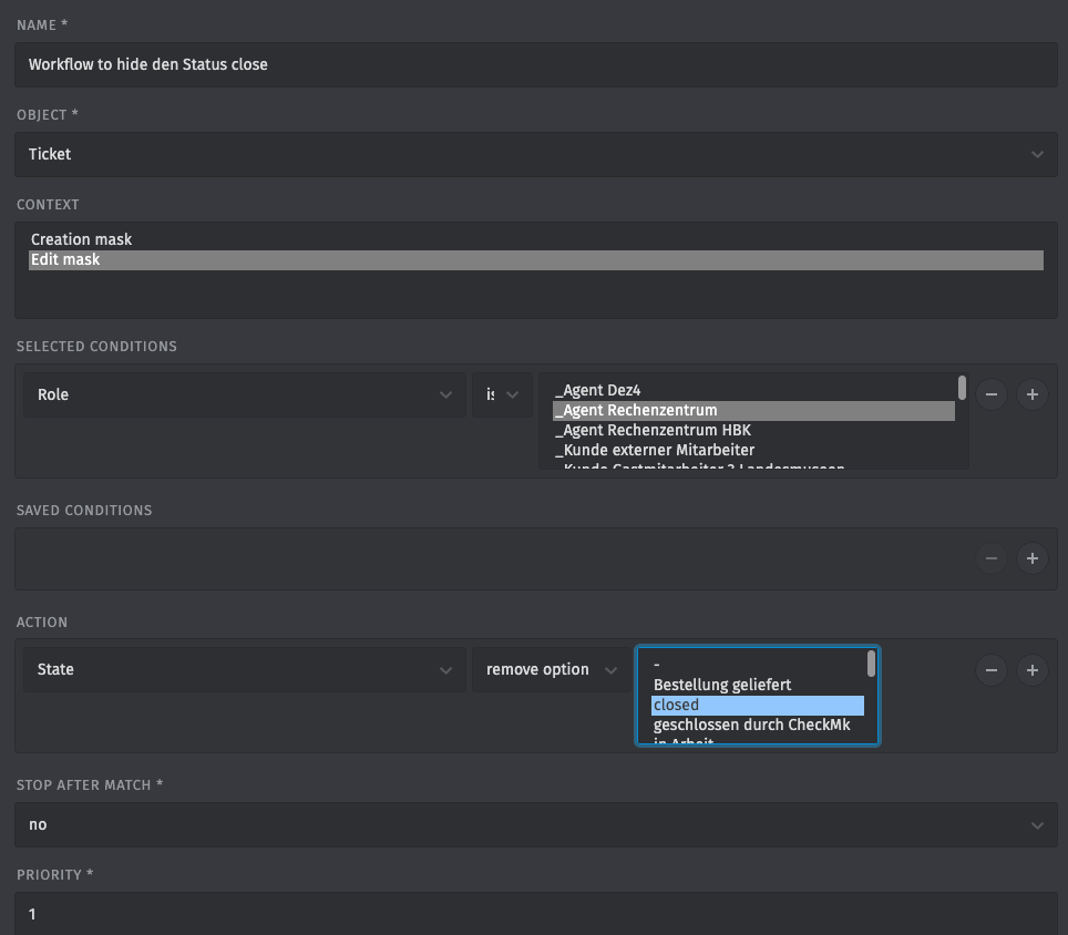

As Workaround: You can create two core workflows. The first one has a higher priority, for example, 1. There, you specify for the Edit mask under Selected Conditions that all those with the role “Your Agent Roles” will then have the status “Closed” removed under Action.
The second workflow has a different priority than Example 2. There, again in the Edit mask under Selected Conditions, you specify the role “Your Agent Roles” and “Updated By is the current user.” As an Action, you add the status “Closed” again.
This should ensure that as soon as the current user with the role “Agent” only sees the status “Closed” after they have updated the ticket. However, this also means that once the customer has finally updated the ticket, the agent has to update the ticket again, such as with a note that the issue is resolved or something similar, so that the status “Closed” appears again.
I’m afraid I don’t quite follow. Any chance you could show me what you mean with a couple of screenshots? ![]()
You need to configure the two core workflows as follows:
To be safe, I would still include the group of agents as conditions in the workflows so that no unexpected effects appear for others

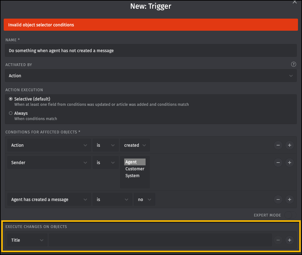

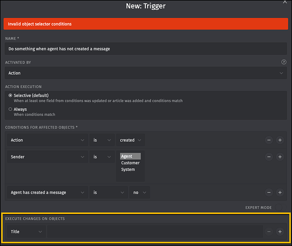

Hi Kevin,
I tried following your proposed solution, but it’s not quite clear to me, what to select in the “execute changes on objecs” section of the trigger:
Hey,
you let the trigger change the field “Agent has created a message” to Yes.
So every time when the field “Agent has created a message” is “no” and a agent creates a article in a ticket the trigger fires and set the file “Agent has created a message” to “Yes”.
