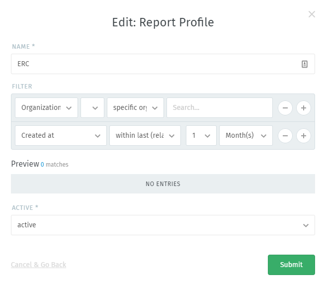

Hi - it might be me, but I’m following the guidelines in the Zammad Docs (Report Profiles and Reporting — Zammad Admin Documentation documentation) and I’m still having an issue creating reports.
I have an Organisation in Zammad with domain based assigning and that works. Tickets from that domain do get assigned to the Org.
In Report Profiles, When I try to create a report to show tickets within the last month. I cannot select the organisation. It says “Search…” in the text box, so I would assume I’d get a drop down as I begin to type the client name, but I don’t. If I type the name of the organisation in the box, I get 0 tickets. If I save and then open the profile again, the Organisation name is missing.
I’ve tried in Chrome, Firefox and Opera. Opera is my main browser. I have the latest versions of each. Cache cleared also.
Does Elastic search have anything to do with this feature?
As I think I balsed up that install… This is only a development Zammad install so I am happy to trash it and start again if need be.
You need a running and working elasticsearch instance, yes. :slight_smile:
OK great - I will try it later. I installed Zammad first and then Elasticsearch so that might be why.
No Problem.
You might need to reindex for elasticsearch to get the content needed. :slight_smile:
