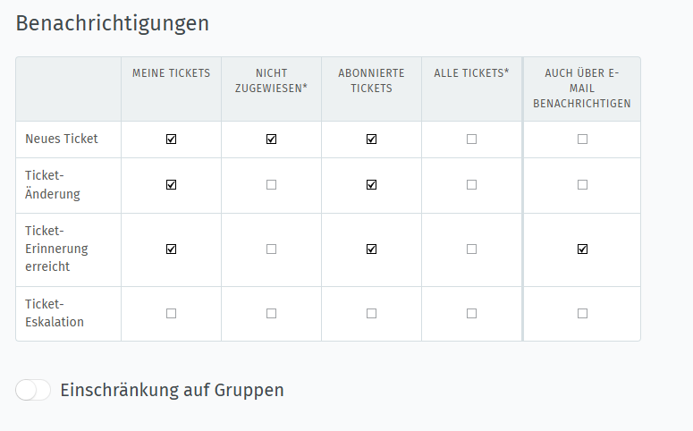

Hey Fliebe,
thank you for your answer.
I think you mean these settings?`

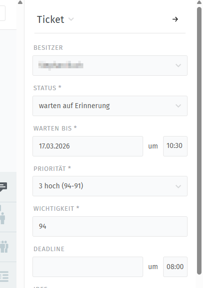

My steps.
In a Ticket → set Status to wait for Reminder an then set the date. Save. That´sall.
Is this the information you deeded?
Thank you :slight_smile:
