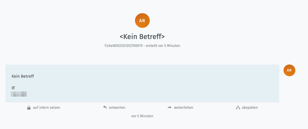

Hi,
i tried your regex and i cant see that it works. A Mail with empty Subject will not be tagged and so my Trigger doesnt will not be triggered. My Regex for the “-” works fine.
Could it be posible that Mails with empty Subject are changed by the System? I can see that empty Subject are presented as “”
Do i need my regex filter to look for “”?

The fault is that Zammad adds the - during ticket creation not during the evaluation of the mail subject.
During the postmaster filter check the subject still should be “empty”.

The issue is not that the mail contains - but that the original mails subject is in fact empty.
You could reject / drop those kind of emails on email server side.
The filter @matsc-h suggested does work, but in my test filters slithgly more like also . subjects.
I couldn’t find a more stable way and gave up after investing 20 minutes with fiddling.
What I can tell:
- subjects are not evaluated. This means the filter indeed runs before the sign is being added to the ticket title. Hopefully this helps at least a bit.
