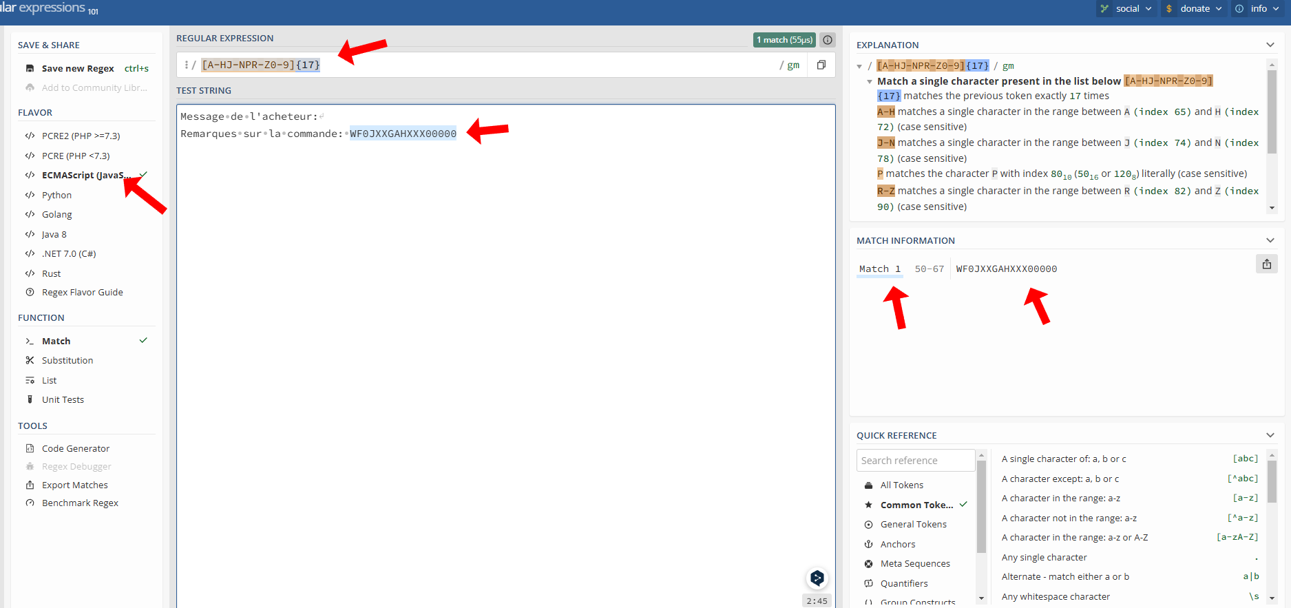

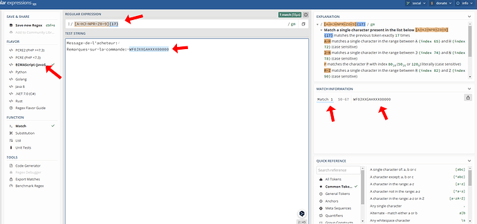

The regex filter does not seem to work within Zammad’s postmaster. Even though I have verified the regex on regex101 using the ECMA (JavaScript) flavor — which confirms that it correctly matches the sample VIN — Zammad does not recognize or trigger the filter when processing incoming emails.

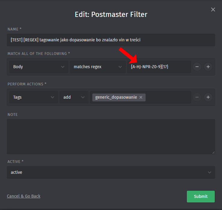

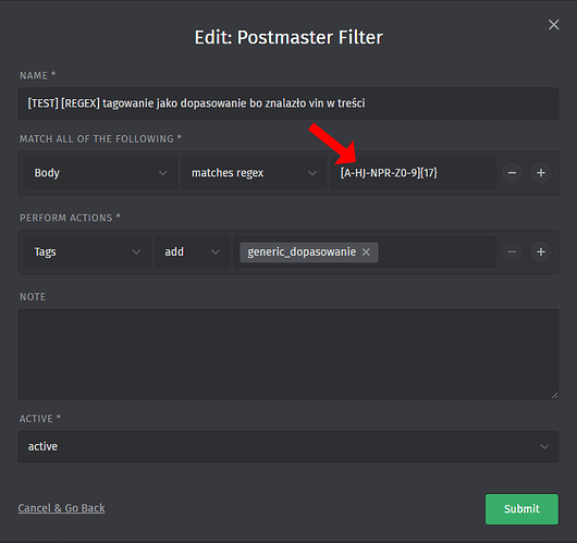

  1. Configure a postmaster filter in Zammad.
  2. Use the regex condition [A-HJ-NPR-Z0-9]{17} on the email body field.

I have attached screenshots of my configuration and the regex101 test results for further context.

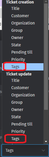

I managed to solve the problem. There is a significant difference between adding a tag on ticket creation and when ticket update.
I had configured the regex to be applied during updates, which in testing made it seem as if Zammad was ignoring the regex. I’ve attached a screenshot—maybe someone else with a similar issue can help. Regards.
