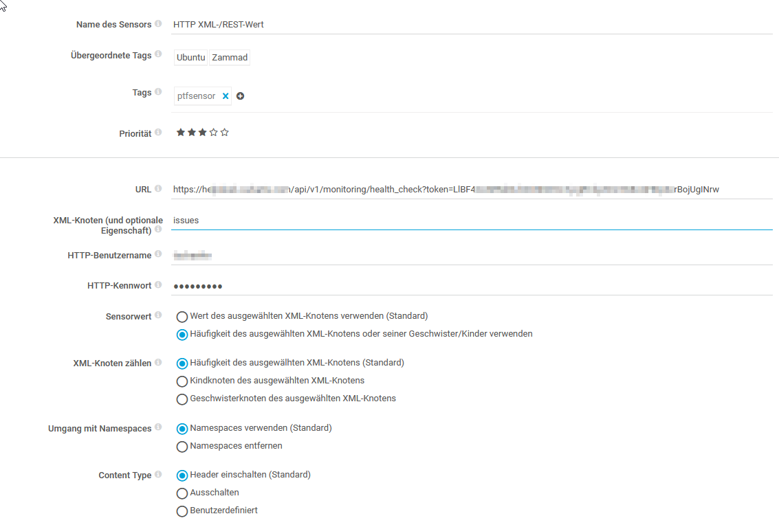

You could also share your configuration so fellow PRTG users might find a solution thanks to your feedback. optional of course. :slight_smile:
Sure:
PRTG-Sensor
Type: HTTP XML-/REST-Wert.
URL: https://helpdesk.blabla.com/api/v1/monitoring/health_check?token=ASDSSDSDGSDGDFG
XML-Node: issues
Define Alarm Values 0 / 1.
Thats it.
