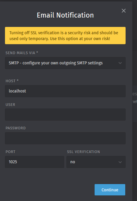

  • Set up Zammad Email notification account with mailpit SMTP
    • Host: localhost
    • Port: 1025
    • SSL Verification: no

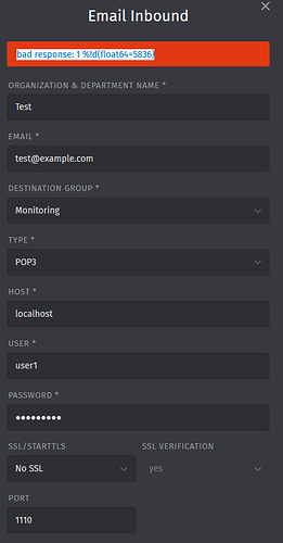

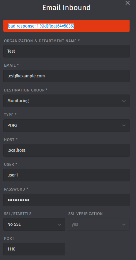

Try to set up the mailbox and get the EOF error

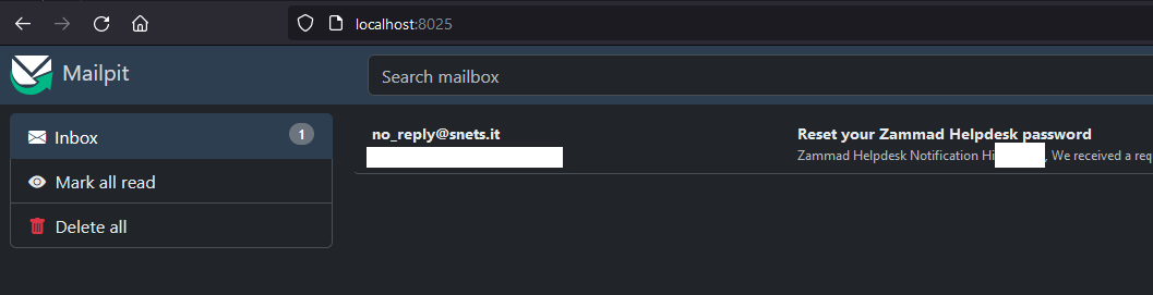

  • Logout from Zammad and send a recover password email. Receive the email in mailpit as shown above
  • Try again to set up the mail channel and get the bad response: 1 %!d(float64=5836) error

Hi @skip. It seems that Mailpit is not compatible to the way how the Net::POP3 Ruby library is fetching mails.
More technical information: net-pop/lib/net/pop.rb at e8d0afe2773b9eb6a23c39e9e437f6fc0fc7c733 · ruby/net-pop · GitHub
This is the line that is shown in your screenshot.

So far I have fixed the bad response: 1 %!d(float64=5836) error with this PR @ mailpit
Now I am looking into the end of file reached error.

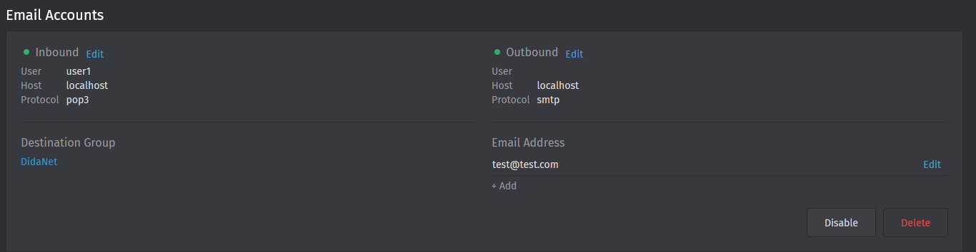

Added full support for POP3 to Mailpit with this commit
Now I was able to add the POP3 account to Zammad

Fixed with the latest 1.18.6 release
Now it works fine with Zammad
