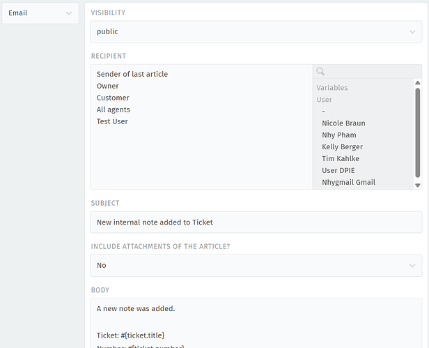

When an admin adds a note into the ticket, the email will be triggered using the Email trigger setting, and email will be sent to customer to alert him/her to check the ticket response from support team.
Receive the email but with the error :
Ticket (This is test ticket from support team) has been updated by “-”.
Information:
Unable to send email to ‘user1@abc.com’: undefined method `to_classname’ for nil:NilClass
Put a note to the ticket.
Got the error message, coming via email.

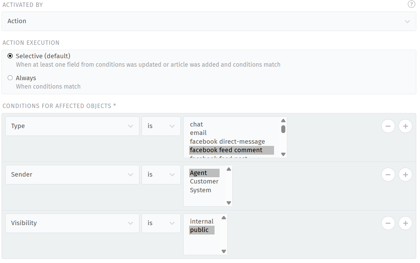

Try removing the sender of the last article from the trigger, since emails are sent by the email account that is configured in the group. This means that the email sends an email to itself.

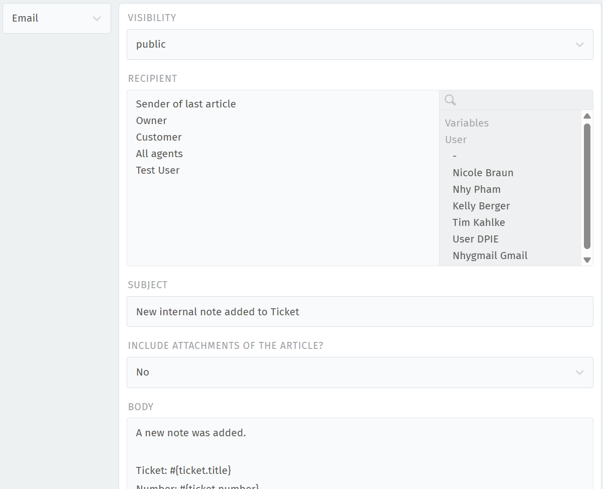

Thank you @Bozo0511 for your prompt advice. I removed the last article from the trigger and still got the same error.
This is the email Article I got from the rail console. It confirmed that the email was triggered, but could not be sent because of the error [undefined method `to_classname’ for nil:NilClass] in the Preference.
Thank you again for your help.
