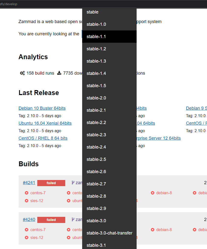

On packer.io there is no tag for the stable version. without that i can only use “stable” but this upgrade to newer major/minor version…
it’s possible to tag the current version also?
Sorry but I am really confused, there are stable tags for specific versions, even though I’d always suggest to use stable to keep your Zammad up to date. stable is the current 3.2 with rolling updates. Stable will, when 3.3 comes out, “change” to a new Tag stable-3.2 and 3.3 will be the new stable.
we have installed stable (3.2) and now it’s not possible to stay at this version (and install only patches for bugs/security problems) because there is no “stable-3.2” tag…
background: we want to update patches automatically and upgrade manually…

Maybe I have expressed myself misleadingly … There is a tag “stable-X.X” for all versions except for the latest one. That I would just like another tag for the latest version. Version 3.2 is currently the one with the tag “stable”. In addition, it would now only need a “stable-3.2” tag, which would currently only be an “alias” for “stable”. From my point of view this has nothing to do with the “way of working”, but only with the fact that you add another tag to it in addition to “stable”!?
In my view, this is an unsuitable argument. A problem that you do not recognize after an automatic patch (!!!) update, you probably do not recognize with a manual update. In the business environment, I don’t think it is unusual to just install the patches very quickly for security reasons (no matter how) and not to upgrade the software. But I don’t want to have a philosophical discussion about update strategies here. The core of the feature request was only that you can explicitly “select” the latest version (like all older ones too).
It just wouldn’t make sense if Zammad dont patch older versions!?. Unfortunately I didn’t find any official information about the release cycle. However, the post like New Release | Zammad 3.2.0 (minor) und 3.1.1 (patch) suggest that the second last version still receives patches!? And so the process that I mentioned makes sense to us from my point of view.
