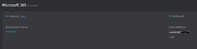

I have correctly setup the O365 chennale with my inbound mail:
helpdesk@xxx.it
When try to send mail on the helpdesk@xxx.it i receive the mail correctly in the account, in the account but no ticket creation in Zammad.
I’m missing something?
Thank you

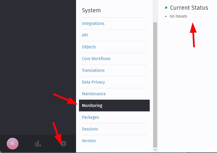

Is there an error in monitoring?
No error.

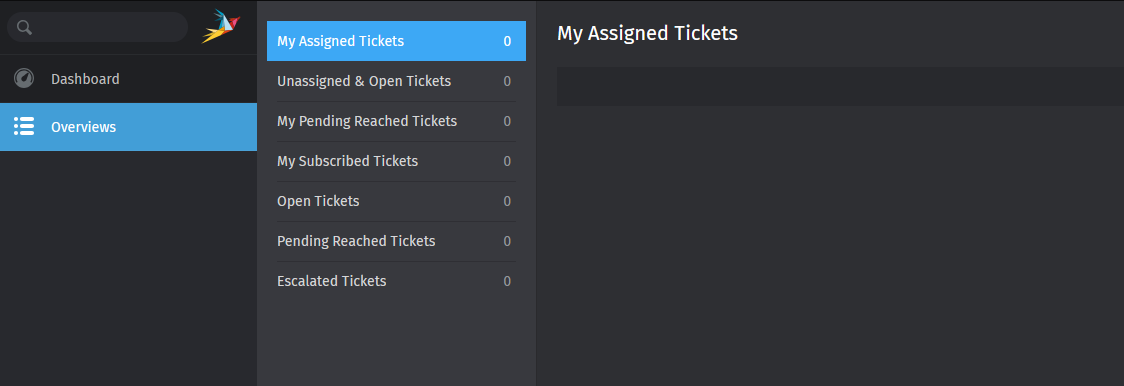

Do you have an overview that shows all tickets, or is your overview filtering out tickets in some way?
I would start by going through your Overview, Email Filters, Triggers, to see if there is something in there causing this.

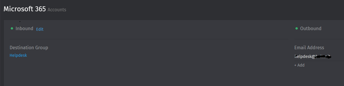

Only the Office 365 integration are configured
helpdesk@ is the eamail address and it creates tickets in the Helpdesk group.
Does that group have an email associated with it? Does that overview include the Helpdesk group?

If that doesn’t help, ensure you have permission to actually see the tickets (group permission) and that the overview does not exclude the group the ticket is going to.
First thing I would suggest is to make sure you aren’t marking the email as read before Zammad gets a chance to read it.
Then make sure your overview ‘Unassigned & Open Tickets’ includes the Helpdesk group.
https://admin-docs.zammad.org/en/latest/manage/overviews.html
