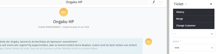

please open the affected ticket, click on “v” next to Ticket and press "History.
There you’ll find anything that zammad has done to the ticket.
