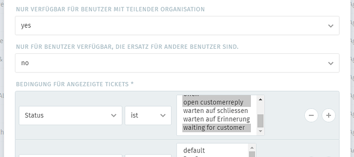

The ticket states are now visible when you edit a overview:
But nowhere else :face_with_raised_eyebrow:

we tried to create some ticket states and ticket state types (for the ticket states). But they are not visible when editing a ticket:
But when working with the overviews, they are visible:
