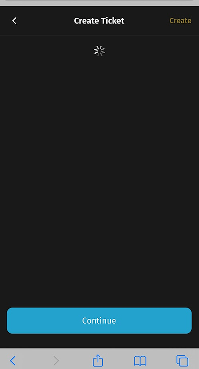

Hi,
I’m trying to deploy our zammad installation via the azure app proxy outside of our network. It’s working as expected, including pre-authentication through entra-id conditional access policies and kerberos single-sign-on.
The only thing not working is opening and creating a ticket in the mobile view. This results in a never ending spinning circle.

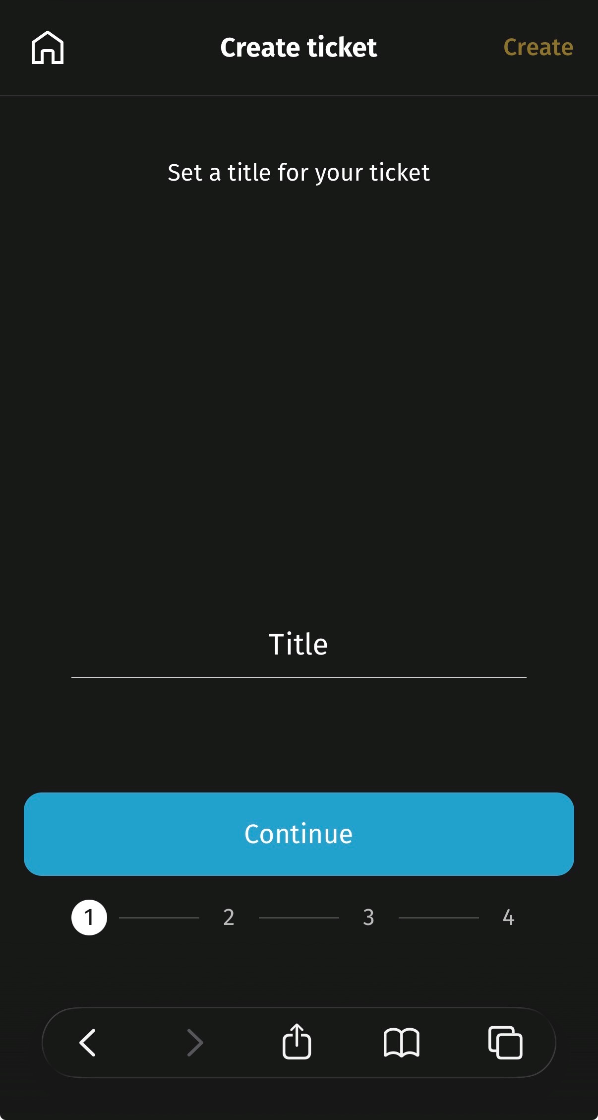

Opening or creating a ticket in the mobile view inside our network is working as expected. It’s also working over the azure app proxy if I switch to the desktop view.

As I said, this problem only occurs in the mobile view over the azure app proxy when viewing or creating tickets. Everything else is working, including the mobile view in the internal network and the desktop view over the azure app proxy.
