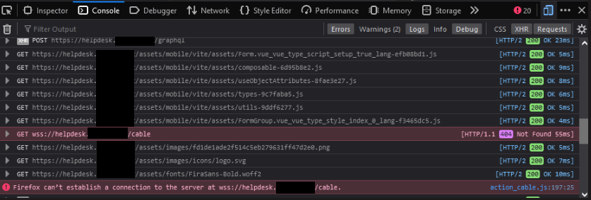

Also “Cable”
action cable
location /cable {
proxy_http_version 1.1;
proxy_set_header Connection “Upgrade”;
proxy_read_timeout 86400;
proxy_pass http://zammad-railsserver;

 # action cable
location /cable {
    proxy_set_header Connection "Upgrade";

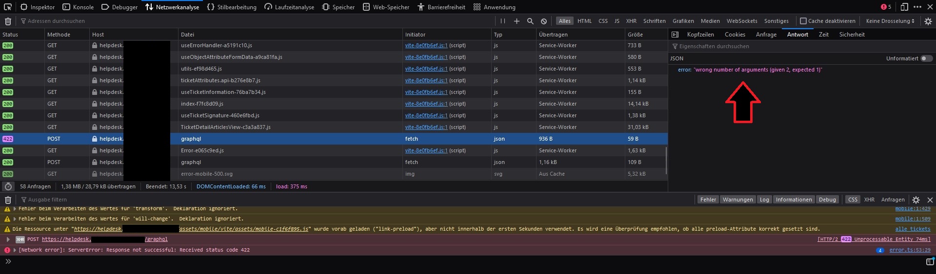

-Inspecting with Firefox Developer Tools. (See image)

This is the production log, from the moment when we try to open a ticket (in the mobile view). We see the “Error” “ERROR – : wrong number of arguments,” but we can’t make much sense of the information. Do you have any ideas?

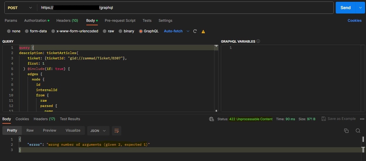

@dominikklein thank you for the suggestion.
I tried to POST your example query to our zammad installation using Postman by doing the following:
  1. change method to POST and enter the FQDN + /graphql
  2. adding Headers:
  • Content-Type = “application/json”
  • Authorization = “Token token=[API-Token]”
  1. under “body” select “GraphQL” and paste your example query
I hope this was correct.
The response is exactly the same as when we open a ticket on the mobile site:
Is there anything else we can try? It seems like our GraphQL has an issue.

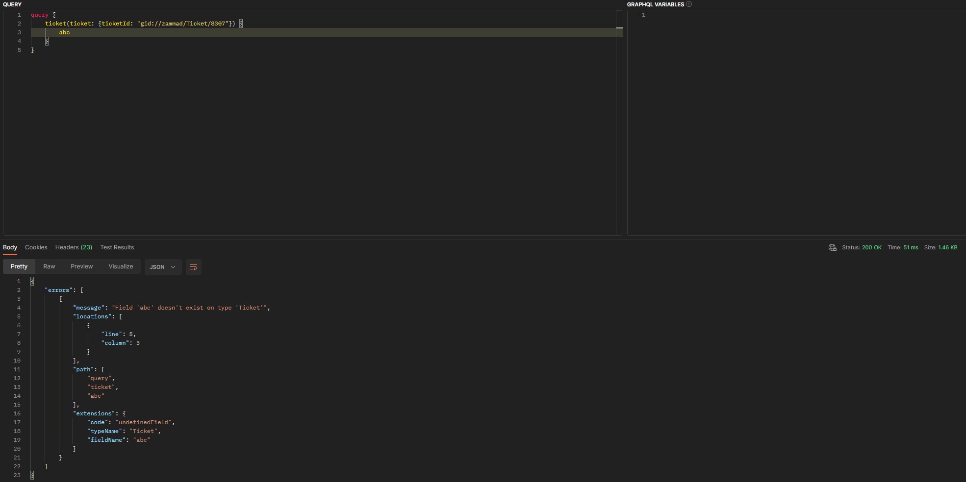

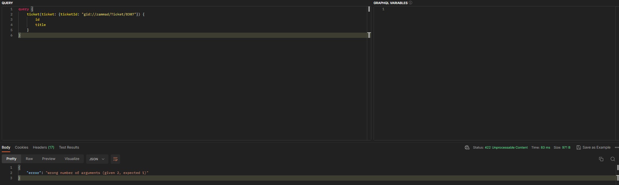

Ok, this is very strange, but better for debugging, maybe you can check it with a simple query:
query {
	ticket(ticket: {ticketId: "gid://zammad/Ticket/8307"}) {
		id
		title
Even with this short query I get the same error
If I try with a random string that doesnt exist in the database, I get 200 OK, so the POST itself seems to work:
