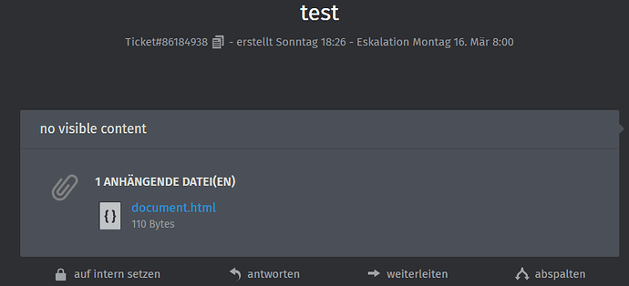

Mail body is imported as attachment for emails since update to Zammad 7
Hello Zammad Community,
hello Support Team,
after updating to Zammad 7, we noticed a strange behavior with incoming emails from web mailboxes such as GMX/WEB.DE.
Has anyone seen this before, or is this already a known issue?
Environment
  • Zammad: package installation
  • OS: Debian 13.3
  • VM: VMware
  • Affected senders: GMX / WEB.DE …webmail
  • Not affected anymore after cache cleanup: Office 365 mails
  • all Browsers
Description
Since updating to Zammad 7, we are seeing a problem with incoming emails from web mailboxes such as GMX/WEB.DE.
If we receive an email from such a mailbox, Zammad sometimes creates an attachment containing the message body, instead of treating the content as the normal article body.
This is not related to the mailbox connection type on our side. It does not matter whether the mailbox is connected via:
  • IMAP
  • Graph / Office 365
The important point is:
  • the issue happens when the sender uses a web mailbox such as GMX/WEB.DE
  • it is about the format of the incoming email
  • if a real attachment is included, usually only the real attachment appears correctly
  • The email body should be imported as the article body and not as an attachment.
  • For some mails from web mailboxes, Zammad creates an incorrect attachment that contains the message text/body.
  • Update to Zammad 7
Additional information
The issue started after updating to Zammad 7.
Raw .eml examples of a problematic mail and a working comparison mail are available.
From the headers / MIME structure we could already see a difference:
  • problematic mails from web mailboxes were simple single-part HTML mails
    (Content-Type: text/html; charset=UTF-8)
  • working mails were structured as multipart mails
    (for example multipart/related with a separate HTML part)
This suggests that the problem may be related to the handling of single-part HTML emails without attachments.
Thanks alot

thanks for your quick reply - it seems like im not allowed to upload eml files.
How could i provide them for you?

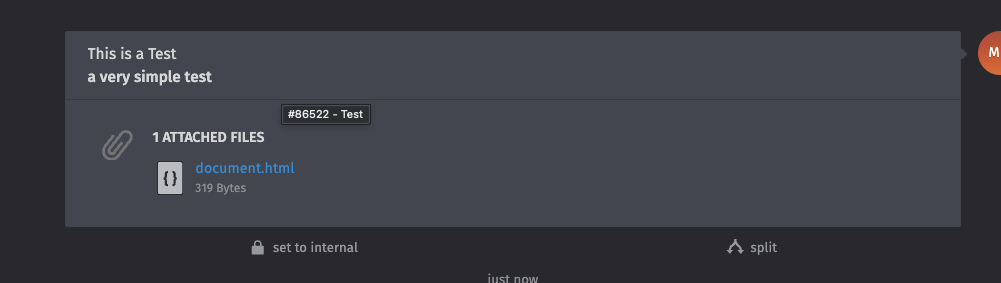

What we noticed is this:
  • The working email was structured as a proper multipart message
    (multipart/related with a separate HTML part and additional inline content such as images).
  • The problematic email was just a simple single-part HTML email
    (Content-Type: text/html; charset=UTF-8, no multipart/*).
  • Another important detail:
    when we send the same kind of email from a web mailbox but include a real attachment, then in Zammad only the real attachment shows up correctly. In that case, the issue with the message body being turned into an attachment does not happen.
So the pattern seems to be:
  • single-part HTML mail from a web mailbox, no real attachment → problem occurs
  • mail from a web mailbox with a real attachment → processed correctly
This makes it look like the issue is related to how Zammad handles simple single-part HTML emails without multipart structure.
Thanks

This ist how it looks like if i send a Email with just a subject.
Interesting. I’m using a dovecot IMAP server with postfix to retrieve email.
I do see a similar result, but not exactly. I do have visible content interestingly.
I also cross checked Zammad 6.5 with the same constellation, looks like a bug.
