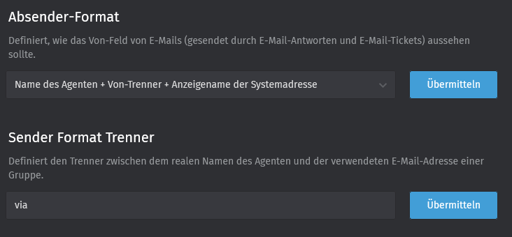

The display name and separator setting:

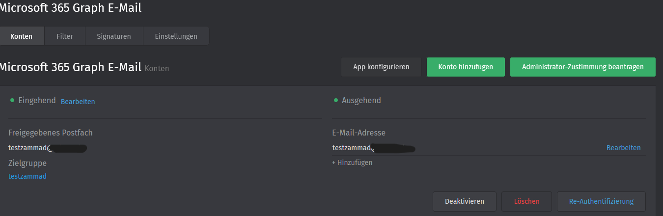

The shared mailbox via graph:

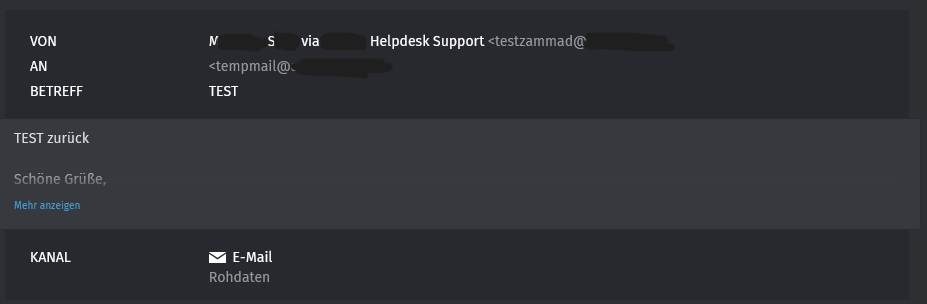

The outgoing mail from Zammad to fresh mailbox (from any webhoster):
Things are looking okay in Zammad

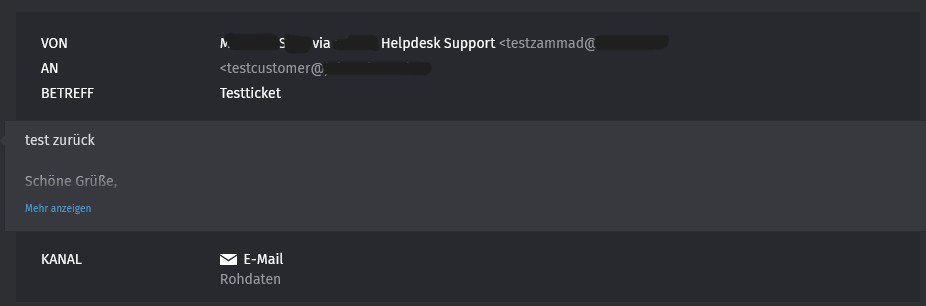

The outgoing mail from Zammad to fresh mailbox (from a another webhoster):
