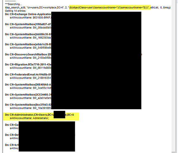

Yes the administrator account appears with LDAP-Search for the given conditions, for example with the ldp.exe utility in windows, I can see the administrator object with the same filter. So in my opinion the ldap query works.
