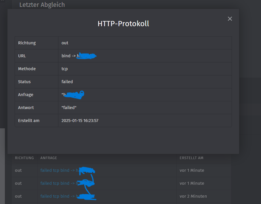

In the meantime, I am working on the problem with a colleague. He has found out via the debug mode of the LDAP import that there is a second user session in the database. The same user, but with a 1 appended. So instead of “user” there was a “user1”. We deleted both users and started a re-import. The original user was then available, but I cannot log in with it. The LDAP integration shows the following error:
At this point, we don’t know what to do.
Ok, that was hard. The password from this user was in meantime expired. After renew the login works. I will continue to observe.
