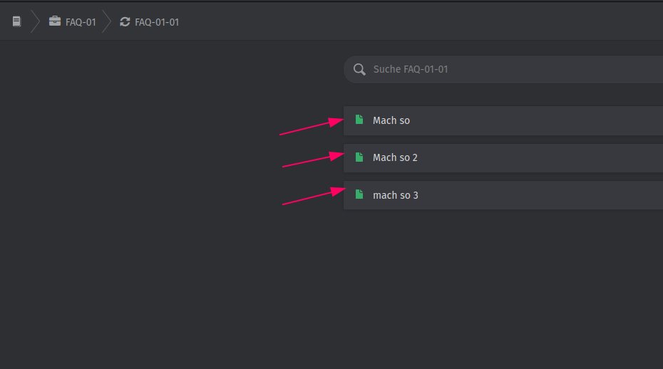

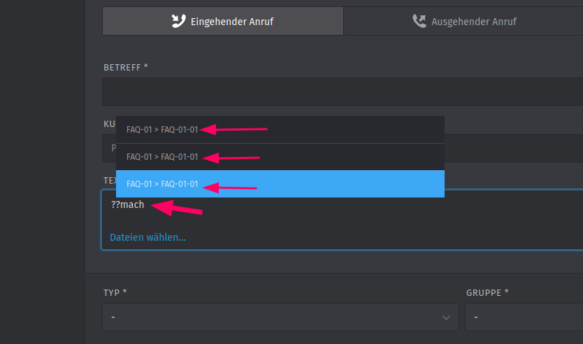

  • if you want to take over a Knowledge Base article by “??” as Shortcut, it seems that only the categories are listed as Display name. even though the answer Title should be displayed there.
  • typ ??

Plugin not, but we once had the problem that text modules are not sorted alphabetically. for this we had added in text modules JS few line codes. If I remove that the answers are displayed. Whatever, sorry I caused this myself.
